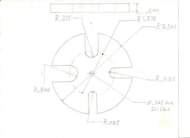

It was suggested that drawings for arbor plates or "Daisy Wheels" for various machines should be added to the Wiki.
This is a drawing of an arbor plate for a Greenerd #2 I had made. I will contact someone to have it made into a DFX file and replace it when done.
If others wish to add to this page contact me by PM.
