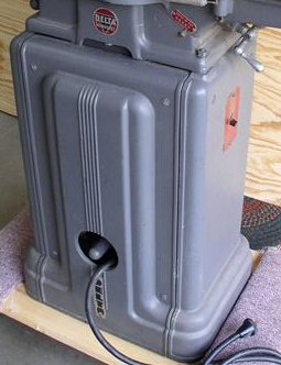

Delta No. 667 Cast Iron Stand¶
The first cast iron base (not counting grinders and multi-spindle drill press set-ups) was for the No. 654 Delta 6” Jointer (NJ casting numbers). It appeared in the 1939 catalogs as the No. 667 Cast Iron Stand. Combined with the No. 654 jointer it was sold as the No. 666 6” Jointer. The cast iron stand was offered as an option to the No. 656 Steel Stand.
The significant parts that make up the No. 667 stand are:
- NJ-273 Front Base Panel
- NJ-275 Right Hand Base Panel
- NJ-276 Left Hand Base Panel
- NJ-277 Motor Plate
- NJ-283 5/16-18 Knurled Nuts (4-req’d.)
- NJ-287 Pulley Guard
- NJ-288 Rear Base Panel
- Cat. No. 132 Switch Box With SP-2458 Switch (purchased separately)
- DP-741 Front Name Plate (Vertical DELTA Plate)
- LSR-35 Delta Switch Plate Cover (domestic machines)
- LSR-36 TAUCO Switch Plate Cover (export machines)
There are additional parts and pieces (brackets and fasteners) that make up the rest of the stand not mentioned for the sake of brevity. Four of the knurled nuts held on the back panel and the other four were used below the motor plate to adjust the height of the motor inside the cabinet.
As an aside, the DP-741 Front Name Plate was borrowed from the No. 1399 Cast Iron Legs used with the multi-drill set-ups for the 14” and 17” drill presses. A wee factoid I learned just yesterday (Sept. 2006) at Ben Rock’s.
The No. 132 switch was a separate purchase with this and other stands. The switch plate cover came with the stand screwed in place over the hole provided on the right hand base panel.
The original No. 667 stands did not have a hole in the front panels for the double shafted motors. It is assumed that the hole was added when the stand was fitted out to accept the 6" X 48" belt finisher (see below). Also different on the early stands were the machine pulley cover. It had a straight taper as opposed to the flare found on the later stands. The stand first sold for $21.95.

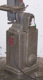

Delta No. 886 Cast Iron Stand¶
The next cast iron stand to be offered by Delta was the No. 886 for the No. 890 14” Wood Cutting Band Saw and the No. 880 14” Metal Cutting Band Saw. It first appeared in the 1941 catalog. It was offered as an option to the No. 891 Open Steel Stand.
No. 886 Cast Iron Stand (not original color)
The significant parts that make up the No. 886 stand are:
- LBS-225 Front Base Panel
- LBS-226 Rear Base Panel
- LBS-227 Left Hand Base Panel
- LBS-228 Right Hand Base Panel
- LBS-229 Motor Mounting Plate
- LBS-194 Cover Casting for Cat. No. 883 Cast Iron Hinged Belt Guard
- NJ-283 5/16-18 Knurled Nuts (8-req’d.)
In 1944 the Cat. No. 883 Cast Iron Belt Guard was replaced with the No. 883 Pressed Steel Guard.
In 1962 Delta brought out the No. 50-122 Totally Enclosed Steel Stand. This was offered in addition to the cast iron and open steel stands.
The No. 886 Cast Iron Stand was offered up until 1966. At that time it sold for $82.00.
