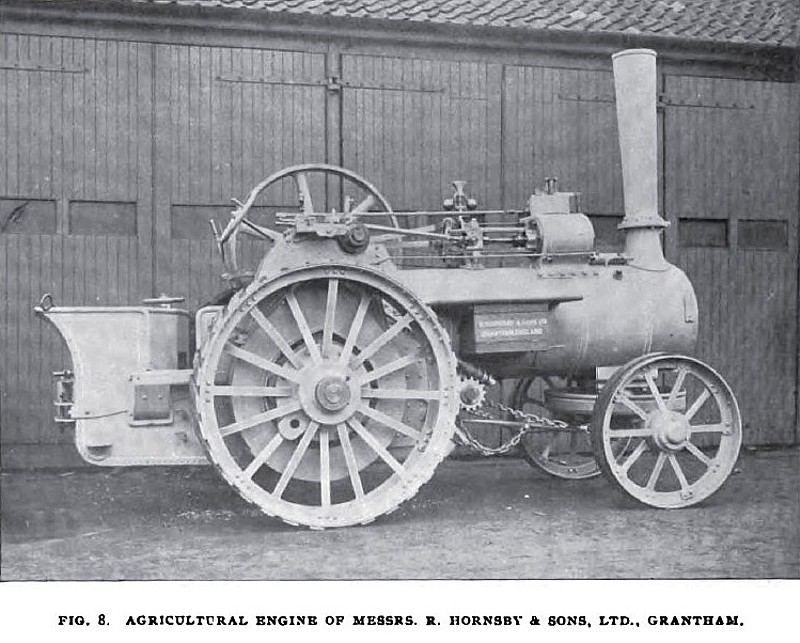

      Fig. 8 represents a very neatly designed agricultural locomotive, made by Messrs. R. Hornsby & Sons, of Grantham. There are several features of interest that distinguish this engine from those already described. It is an outside gear engine. The box bracket plates are riveted to the firebox shell, having transverse plates riveted in between them to give them the requisite stiffness. A neat bracket carries the two slide bars, the governor and throttle valve spindle, the valve rod guide, and the bar for the reversing gearing. The whole of the steel driving gear is cased in to preserve it from the dust, and to suppress noise.
The dome on the top of the cylinder is in direct communication with the steam jacket round the barrel of the cylinder, and these spaces combined form a large reservoir, from the highest part of which the steam enters the stop valve. The governor is of the cross-armed or approximate parabolic type, very sensitive in work. A wooden platform is provided on the side of the boiler barrel, from which the engine driver can reach to oil or clean all parts of the engine. Underneath this footboard a very large toolbox is hung. A round tray is fitted on the front axle for carrying loose tools, chains, etc. All the handles and levers are conveniently arranged, so that one man can, if required, drive and steer the engine.

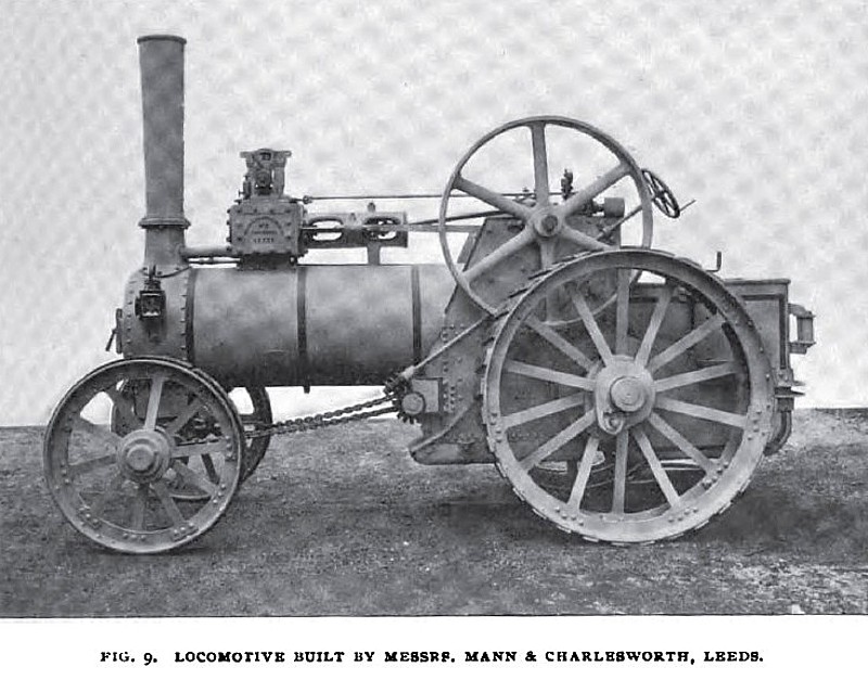

      The agricultural locomotive shown in Fig. 9 and built by Messrs. Mann & Charlesworth, of Leeds, possesses several novel features. The ordinary link motion reversing gear has been dispensed with, and in its place the firm's patent single eccentric reversing gear has been applied. This enables one eccentric and rod to do all that is required in working expansively when running forward or backward, and for reversing the motion. The eccentric is shifted from full forward to full backward without altering the lead. Its movement resembles that of the parallel ruler, as in any position it remains parallel to the centre line of the engine and at right angles to the crankshaft, and the driving pinions for the two speeds are placed between two of these bearings, but outside the box bracket. The governor is fixed over an equilibrium throttle valve in the cylinder. By using steel castings in place of cast-iron, the weight has been considerably diminished without reducing the strength, or limiting the efficiency.

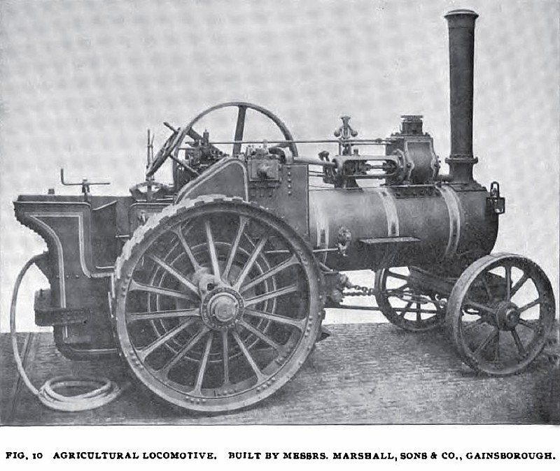

      In Figs. 10 and 11 are shown both sides of a very well designed agricultural locomotive, made by the well known firm Messrs. Marshall, Sons & Co., of Gainsborough. These traction engines have been improved from time to time and possess all the latest devices suggested by a long experience. It is impossible to speak too highly of the efficiency and good workmanship of Messrs. Marshall's productions. The cylinder is thoroughly steam-jacketed, and the steam supply, the circulation and the drainage of the jacket have received careful attention. Bored guides are used instead of the usual slide bars, and the outer end is supported by a bracket that serves as a guide for the valve rod, and a stand for the governor and throttle valve spindle, as well as for the details of the reversing gear.
      The sides of the tender are flanged so as to reduce the riveting, increase the strength and give the tender a neater appearance. Some of the gearing is placed in the box bracket; the remaining gearing outside the plate is effectively covered in to protect it from dust and dirt. The steerage worm wheel is placed inside the bearing, instead of outside, as is the usual practice. The engine is fitted with strong compensating gear, a slip winding drum and all the usual tools and appliances for rendering the engine complete and ready for any emergency to be met with in regular threshing or occasional hauling work.

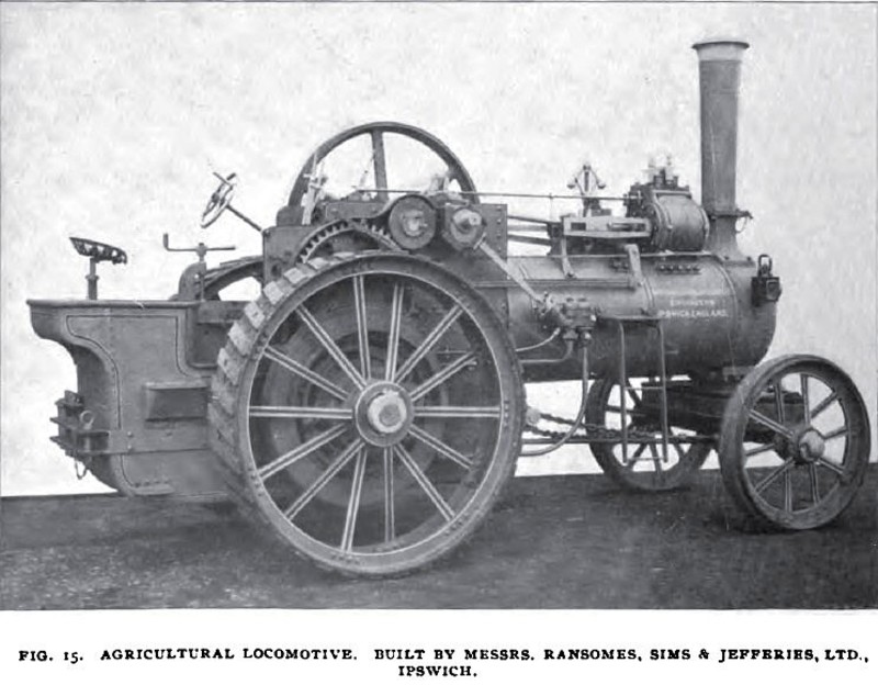

      Fig. 15 shows one of Messrs. Ransomes, Sims & Jefferies' improved agricultural locomotives of the single-cylinder type. A large number of these engines have been manufactured and are doing excellent service on farms.
      A few years ago there was every in dictation that the compound traction engine would become very popular, but this result has hardly been realized. The compound engine has been adopted in many cases, but those makers who have specially boomed their compound engines still continue to make a good number of single-cylinder engines. Some firms say, "We can supply traction engines made on the compound principle, but we recommend the single cylinder engines, as, with the latest improvements, they work very economically and have only half the number of parts." There are other manufacturers who are prepared to supply compound engines, but who are rarely asked for them. The greater proportion of their orders are for single-cylinder engines. For continuous hauling work, however, the compound engine must be recommended. If this type of engine is worked at the full boiler pressure of 150 lbs. per square inch, a saving of thirty per cent, in fuel and water will be secured. The noise produced by the exhaust steam also is reduced, which is an advantage. The shocks upon the crank-pins, gearing and other working parts are less severe. An auxiliary valve is provided which allows high pressure steam to enter both steam chests, and both the cylinders exhaust into a common exit pipe (the compound principle being suspended for the moment), enabling the engine to start readily with a heavy load behind. As soon as the engine is under way the valve is closed. A relief valve is fixed on the low-pressure steam chest.
      For threshing purposes the compound engine cannot be so fully recommended on account of the reduced steam pressure employed for threshing,—from 80 to 100 lbs. pressure being quite sufficient. Not only so, but for this work the attendants are often very unskillful, so that it is an advantage to have the simplest possible engine. The first cost is also a consideration with the threshing fraternity. While on the subject of cylinders we may refer to the proposal to bolt the cylinder on a wrought steel fixing or girder, instead of bolting the casting direct to the boiler barrel as heretofore. The base of the cylinder and the seating are planed, so that, having a flat surface, the joint is more easily made and retained. None of the bolts pass into the steam space. For export engines this method of construction possesses important advantages. Beyond this there does not seem to be any great value in the plan. Now that steam pressures are steadily creeping up, some makers have experienced trouble in keeping the joint tight under the cylinder, around the steam inlet, but if the joint is properly fitted there will be no fear of leakage. In Fig. 16 is given a section of a traction engine cylinder in order to show the steam opening from the boiler, and one method of making a steam tight joint. It will be seen that the cylinder is tapped to receive a pipe which passes through the boiler plate; on the under side of the plate a properly shaped washer is fitted, and a nut is screwed tightly up to it On the bottom end of the pipe a steam collector is also screwed.
      In Messr’s Ransomes’ traction engines this steam joint trouble is nicely remedied. The cylinders in their engines have no steam inlet hole under the foot, but the steam is conducted into the cylinder by a separate elbow so arranged that the joint is easily made and rarely leaks after it is once fixed in position. The bolts around the cylinder foot have to make their own joint only, and if the bolts are turned taper under the head and fit the holes in the boiler plate, iron to iron, without red lead, they will never leak.

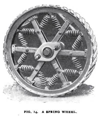

Figure 14
Figure 14
      One of the latest examples of a spring wheel is shown in Fig. 14. The engraving represents Mr. Link's wheel, in which the weight carried is equally distributed through the various details of the wheel. One extremity of the twelve spiral springs is attached to the double spokes, and the other end is secured to the tee-iron rings. By withdrawing the pins, any of the springs can be removed or replaced without interfering with any other part of the wheel. On the spokes, near the sole of the wheel, are cast-iron blocks, which do not touch the inside of the tire, but sufficient space is allowed for their movement, and in order to prevent any play sideways, steel plates are fitted on to the blocks which tit in and fill up the space between the webs of the tee-iron rings.
