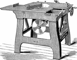

Dave Potts added:
Matt *da torch* Prusik left a 1905 magazine in my mailbox a few weeks ago and one of the items I saw advetised in there was the Colburn saw. I've sent a scan to Jeff Joslin for entry into the Mfg'er index (as opposed to the MF'ers Index) since there were none posted previously.
![Advertisement for the Colburn Saw Table](GetFile.aspx?File=OriginsOfTwoBladedTableSaws%2fcolburn_saw.jpg) Advertisement for the Colburn Saw Table |

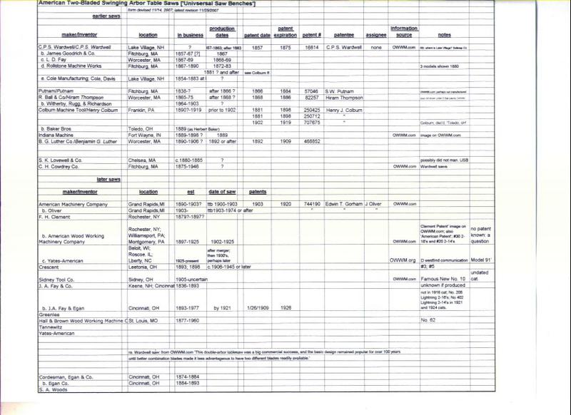

Robert Bernstein added:
Here is a portion of my 'information sheet' regarding these saws as of this moment:
![Table of Two Bladed Table Saws](GetFile.aspx?File=OriginsOfTwoBladedTableSaws%2fTablesawstwoarbor01.jpg) Table of Two Bladed Table Saws |

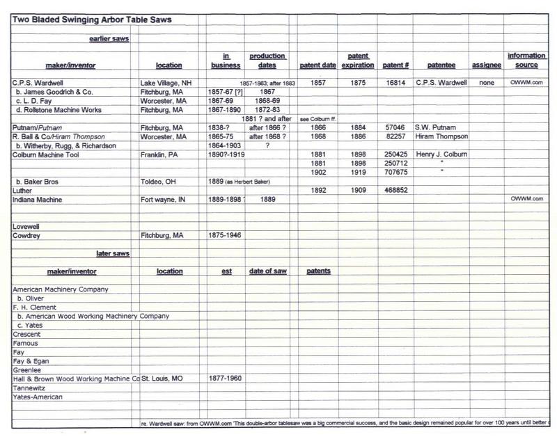

![Updated Table of Two Bladed Table Saws](GetFile.aspx?File=OriginsOfTwoBladedTableSaws%2fTablesawstwoarbor002.jpg) Updated Table of Two Bladed Table Saws |
