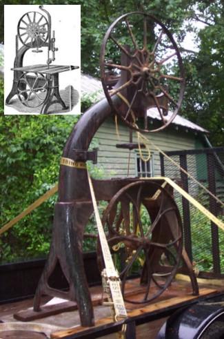

Welch & Chipman saw
Welch, Harrison & Co. saw
The Rogers saw has a rounded cored neck cast integrally with the bed section.
C.B. Rogers & Co saw
Of the other five, four are Pryibil related, two being First & Pryibil and the other two being Pryibil. All these four have rectangular sectioned cored necks cast in one piece, integrally, with the beds.
First & Pryibil 1 First & Pryibil 2 P. Pryibil 1 P. Pryibil 2
The last example is the Collins & Greenwood saw which has a rectangular flanged bed.
All eight pictured examples have legs bolted to the beds. All eight of these saws have cast iron wheels.
Patent dates are recorded as being cast into six of these eight saws. Neither the Collins and Greenwood saw or the Rogers saw has a record of a patent. Indeed, the C.B. Rogers company—active from around 1841 to 1897- held no patents on band saws. The Collins and Greenwood firm did patent, on August 12, 1873, a design for a band saw frame.
Both the Welch, Harrison and the Welch & Chipman saws have the patent date of June 16, 1868 cast into them, and, therefore both saws were manufactured after that date. The four Pryibil related saws have several patent dates attached or cast onto them, as follows:
First & Pryibil (Steere example)August 28, 1866 & Jan 7, 1873
First & Pryibil ('Woodshave' example)said to be 1876
Pryibil (Poore example)August 28, 1866 & Jan 7, 1873
Pryibil (Barnhart example)August 28, 1866 & Jan 7, 1873
Therefore three of the Pryibil examples date would seem to date 1873 or after at the earliest and one in 1876 or after at the earliest.

From this it is quite clear that—beyond the immediate question of band saw dates of manufacture—the three Philadelphia firms were begun as business enterprises in a very few years in a quite different time period than the New England and the mid-Western firm.
That these three Philadelphia firms started operations at the beginning of the period of the manufacture of the commercially successful band saw machine may be pertinent.
