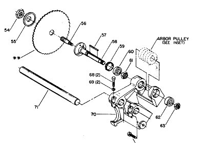

- Remove the end nut on the arbor #63 in drawing. Loosen the set screws holding the pulley to the arbor.
- Loosen completely, the collar #59 (use counterclockwise rotation). A Mallet and a square headed screwdriver work here, if the original $70. wrench is unavailable.
- Drive out the arbor by starting to tap the end of the arbor #58 with an appropriate tool (I used a 3/8" ratchet extension). Tap until the arbor is free of the housing on the right side. Bearing #62 will come off the arbor at this point.
- This should free the arbor from of the casting.
- As I said, the right side bearing #62, should come off easily.
- The Left side bearing #60, will have to be pressed off after removing the nut #61. And the 4-sheave pulley.
- Clean up the arbor as well as the bearing housings in the saw table casting.
- I was able to get the bearings locally. * NOTE: Delta are shipping as of 3/2002, NTN brand (Taiwan), #6204LB for the smaller bearing (dwng #62) and using INK brand (Japan), #3205J2Z for the larger arbor bearing. (dwng #60)
- You might consider, as I did, replacing #63 (nut $4.45) and #59 (collar $15.50) available from Delta.

- Place Collar #59 on the arbor and have the new bearing #60 pressed onto the shaft. Note: Press this bearing on far enough to leave it covering 1 to 2 threads on the arbor. Tighten nut #61 up against the bearing. Do not over tighten!…just use firm pressure. Any slack will be taken up when collar #59 is tightened down, sandwiching the bearing between it and arbor nut #61.
- Insert the arbor (with the collar #59, pressed bearing #60 and bearing nut #61) through the cast housing from left to right, placing the pulley and pulley key on as you go. Right side bearing #62 is place into its casting seat and nut # 63 is hand tightened.
- At this point everything should be where it ought to be, with the pulley loose on it’s key. Nut #61 will be hidden from view in the bearing housing at this point.
- Tighten arbor collar # 59 using a clockwise rotation. Tighten it up against the bearing #60, but don’t fully tighten it yet.
- Tighten arbor end nut #63. This will assure that the bearing is snugly up against the stop on the arbor shaft. This nut should go on far enough to leave 1-2 threads showing on the outside end of the arbor. Snug arbor collar #59 down again and then make sure nut #63 is tight.
- A word about torque here, the nuts #59 and 63 should not be so tight as to crush the bearings. The Delta tech said “not overly tight”. I used the “oil filter technique”…that is, I snugged the nuts down and gave it another 1/2 turn.
- The arbor should spin freely and above all, quietly!!
