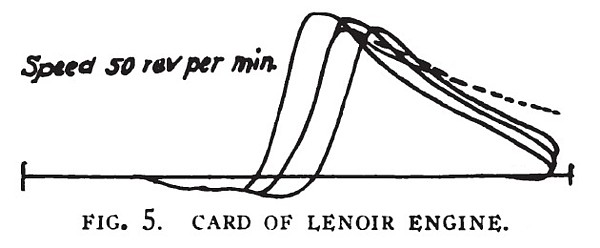

Card of Lenoir Engine
      The Lenoir engine admitted gas and air for part of the stroke, after which the explosion occurred and then an expansion. An indicator card for this engine is shown in Fig. 5. All of these engines, it will be noted, were non-compression engines. In 1860, Beau de Rochas stated the conditions required for the efficiency of an internal-combustion engine as follows:
