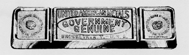

Government Genuine Babbitt Metal
Government Genuine
Government Genuine
Also made by the United American Metals Corporation, this tin based Babbitt is advertised as the highest grade of Babbitt metal made by that company. The composition is 89% tin, 7 1/2% antimony, and 3 1/2% Copper. According to their literature, there is no speed too high; no lead too heavy; no shock too great for Government Genuine Babbitt. This Babbitt is alloyed by the Stanley Process. It is especially adapted for band-saws, connecting rods, clay products machinery, converters, crank-pins, crushers, crushing-rolls, compressors, cutters, centrifugal pumps, dynamos, gas engines, marine engines, mill gearings, saw-mill, arbors, trimmers, steam cylinders, steam pumps, swing saws, turbines and tube mills. Ideal for automobiles, buses, diesel engines, and airplanes.
