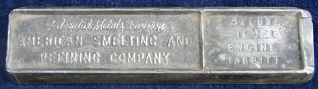

Shelby Diesel Engine Babbitt
 Shelby Diesel Engine Babbitt |
Exact composition is unknown but appears to be a lead based Babbitt.

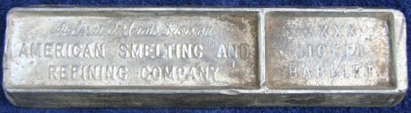

XXXX Nickel Babbitt
 XXXX Nickel Babbitt |

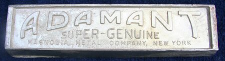

Adamant Super-Genuine Babbitt
 Adamant Super-Genuine Babbitt |
Sold by the
Magnolia Metal Corporation, Adamant Super-Genuine Babbitt is still available for purchase today. Exact composition is not know but this is a tin based babbitt and suspected to be a similar formula as original Babbitt. This product would be preferred over Magnolia Anti-Friction Metal for most high speed applications.
According to the Magnolia Metal Corporation, Adamant Super Genuine Babbitt is "a genuine babbitt metal alloyed especially for malleability, strength and toughness. Will not crack or chip even when subjected to extremely severe shock loads. Easy to pour, conforms well to the shell. Typical Applications... Internal combustion engines... trap rock crushers... sifter machinery."
Pouring temperature for Adamant Super-Genuine Metal is 775-825 degrees F.

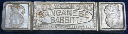

Manganese Babbitt Metal
 Manganese Babbitt |
 Manganese Babbitt Metal |
Yet another brand of babbitt metal made by
United American Metals Corporation. Even though the name contains the name "manganese," according the the companies literature, it does not actually contain any of this element. This lead based babbitt is 5% Tin, 14 3/4% Antimony, and with the remaining balance being Lead. This babbitt is a couple of grades lower than the companies "Stonewall" babbitt and contains less tin, making it most useful for slow turning shafts only.
According to their literature: "There is no bearing that covers so wide a scope of service as Manganese Babbitt. Easy to cast. Makes a solid bearing and is practically self-lubricating."
"Especially adapted for auxiliary pumps bagasse carriers, beaters, calendars, car axles, chemical agitators, clay machinery, conveyors, cotton-mill machinery, cottonseed oil machinery crystallizer drives, driving shafts, elevators, Fourdriniers, hoisting machinery, hydraulic presses, knitting machinery, light capacity pumps, light capacity pumps, light saw-mills, mixing mills, pulverizes, sausage grinders, saw mandrills, saw tables, shapers, woodworking machinery."
