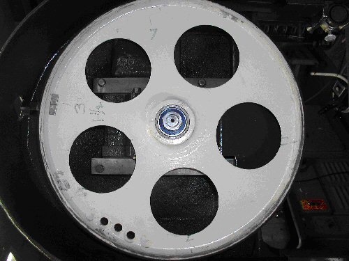

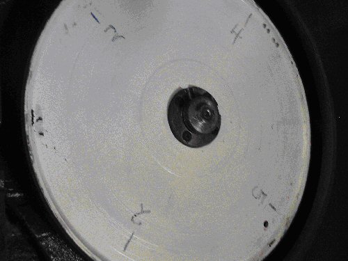

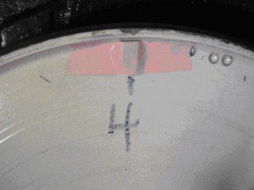

Pick a random spot on the circumference of the wheel near the edge and tape on one of the 1/4 oz wheel weights. Make sure the weight is secure, it is best to have it at the edge near the lip to help hold it in place (Photo 3). Turn the saw on. The dial indicator will register a quick fluctuation of a few thousandths of an inch. Note how many thousandths this fluctuation is, turn the saw off and let it come to a stop. I mark the spot on the wheel and the thousandths vibration with a lumber crayon (Photo 3). Remove the weight and move it along the wheel circumference approximately 90 degrees. Start up the saw again and mark the vibration at this point. Continue working around the wheel until you have four measurements all roughly 90 degrees from each other (Photo 4). You should have a pattern of lower vibration to higher vibration as the weight moved around the wheel (Photo 4).
Photo 3 (1/4 oz wheel weight taped securely near wheel lip)

Photo 4 (vibration in thousandths of an inch)
In this case I had 0.004, 0.005, 0.002, and 0.002 as I went around the wheel. Since I had two spots where I had 0.002 thousandths of vibration I put the weight between them and started the saw. This time the indicator registered only 0.001. Now I know that this is the light side of the wheel that needs weight but I’m still not sure how much weight is needed so I try an additional 1/4 ounce. This time the vibration is only 1/2 of a thousandth or 0.0005 (Photo 5). Just to see if I can do better I add a third weight. This time the indicator measure is back up to 0.002 so obviously 2 of the 1/4 oz weights is best. I then remove the backing from the adhesive back on the weights and attach them securely in place and am done with the lower wheel (Photo 6).
