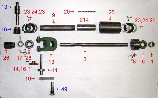

Photo 1 is an exploded view of the major internal parts of the sander and is a good reference when used in conjunction with the manuals/part list. The numbers in the picture correspond to the numbers on the part list diagrams. Blue is Figure 1 and red is Figure 2.

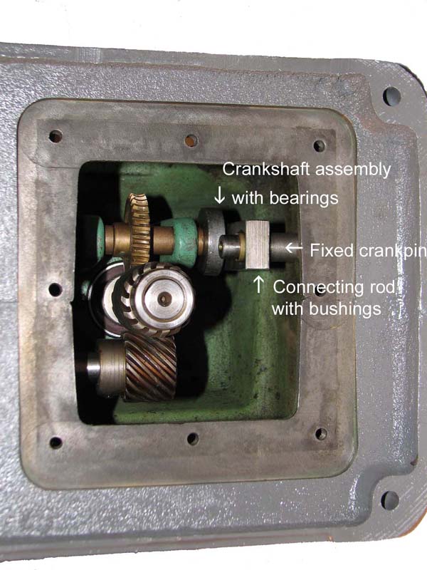

4. Lay the base casting on its side and unscrew the fixed crankpin from the base casting (Photo 5). Steady the connecting rod with bushings to keep it from binding as the fixed crankpin is removed. The connecting rod with bushings can then be slipped off of the crankshaft assembly and removed.

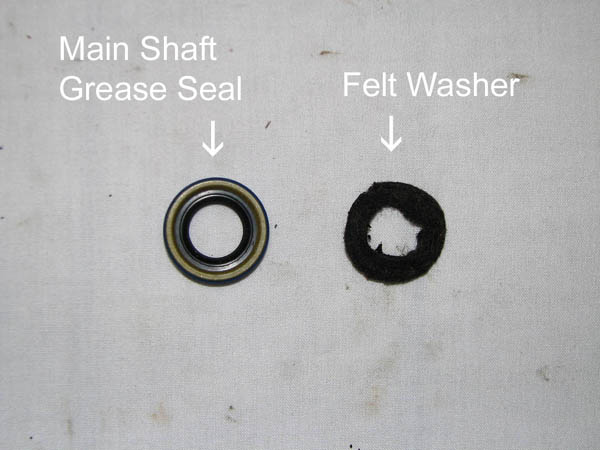

8. After the drive shaft ball bearing is removed from the main casting, remove the main shaft grease seal and the felt washer from the main casting (photo 9).

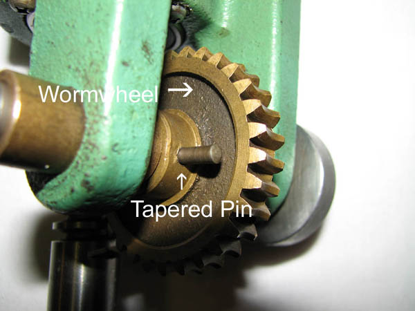

9. Remove the two set screws from the spiral oscillating shaft gear then remove the gear from the spindle (Photo 10). Next drive the tapered pin from the wormwheel and remove the crankshaft assembly, freeing the wormwheel (photos 10 & 11).
