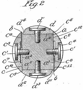

Many older jointers and planers utilized a style of cutterhead now known as "clamshell". A clamshell head head has two ore more steel or cast iron covers which bolt to the cutterhead to make the head "round". While ofter referred to by as "safety cutterheads" in old literature, this style of cutterhead is no longer utilized by modern manufacturers due to safety issues as detailed below.
The problem with a clamshell head is that the knives are directly held in place by the bolt heads. The faster the head spins, the higher the stress on the bolt heads. Hit a knot, and the impact transfers directly to the bolt heads. Now, are the bolts original, never been over-tightened, no stress cracks where the heads meet the stems, made of top-quality steel that was accurately machined and properly heat treated? If you are confident of good answers to all those questions, then your clamshell head should be plenty safe. Otherwise, you are taking chances.
 Patent drawing of an early Clamshell design |
