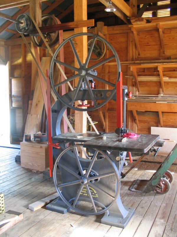

All that is left now is some finishing touches. The original machine had two blade fenders that offered some protection for the worker should they bump into the exposed blades while the saw was running. Trying to make the saw look as original as possible, I took the fender concept one step further by using aluminum angle rather than just a flat piece of metal that covered the back of the blade. The angle would offer more protection by covering two exposed sides of the blade rather than just one. I was able to cut the aluminum with a woodworking jig saw which allowed me to get a profile on the fenders that looked somewhat original.
I touched up some paint here and there and installed a blade and the saw was finally complete! The total restoration took just a few days less than three months. Not too bad considering that I was down for six weeks and unable to do anything on the project while I waited for the new castings to be made. All in all, this restoration is a bit more complicated than most of my restoration projects (mainly due to the broken castings) but fun and gratifying project none the less.
The only minor thing that remains to be done is replace some parts on the Wright guides. When I got the saw, it did not have the original Wright guides but a fellow OWWM'er had a set he was not using and sent them my way. They needed new pads on the jaws and the bottom guide needed a new bearing and wheel. The parts have been ordered but have not come in yet. As soon as they get here, it will take all of about five minuets to install them.
Here are some "finished" pictures of the saw.
 The finished saw installed at the Georgia Agrirama |
