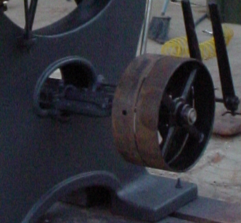

With the bearings finally complete, the restoration process could finally get back into high gear. The bearing were mounted back on saw and the wheels were installed.
 The upper bearing assembly installed and ready for the wheel |
 Lower bearing assembly ready for wheel and pulleys (shot from pulley side) |
