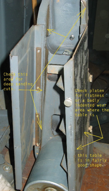

Additional Detail Pictures
These details show various problems one can encounter when buying a used sander.
Table and inside groove:
Lower sanding cut:
