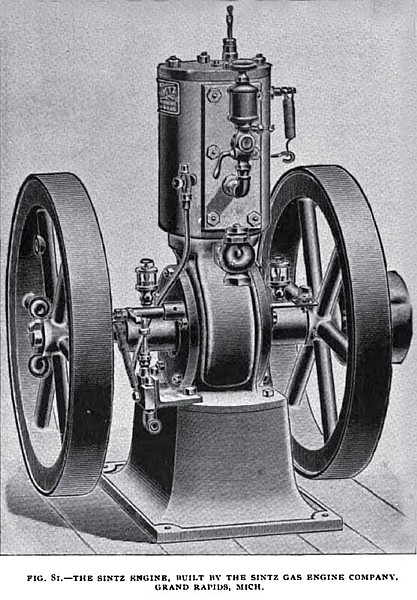

Fig. 81— The Sintz Vertical Gas Engine
      Another engine of American design, more recently put on the market, is the Sintz engine, shown in Fig. 81, and built by the Sintz Gas Engine Company, of Grand Rapids, Mich. It is of the vertical type and is turned out both for gas and gasoline use. When gasoline is to be employed, the engine is provided with a small pump and is connected with a gasoline supply tank conveniently located. The operation of the engine is substantially as follows: When the piston makes its first upward stroke of the working cycle, it draws a charge of air into the crank casing with which, as will be noticed, the engine is fitted. On the following down-stroke, and when near the end of its stroke, the piston passes a port in the side of the cylinder which communicates with the crank chamber. Just as the piston begins to open this port, the small gasoline pump (when gasoline is used) begins its downward or discharge stroke, causing the gasoline to pass into the port in the form of fine spray, and it finishes its stroke at the same time that the main piston completes its downward stroke. In the meantime the air, which has been slightly compressed in the crank chamber, is rushing through the port, and is deflected to the top of the cylinder, carrying the gasoline with it, and forming an explosive mixture.
      The piston, on its next upward stroke, compresses the charge in the upper end of the cylinder where it is ignited electrically at the proper moment and drives the piston down again, this time performing a working stroke. On reaching the end of this stroke an exhaust port is uncovered, about opposite the transfer port already mentioned, and the waste gases are enabled to escape before the fresh charge is transferred to the cylinder. The design is such that an impulse, or explosion, takes place at every revolution while gasoline or gas is supplied. The supply of the oil or gas is controlled by the governor by its action on either the gasoline pump or on the gas valve, depending upon the kind of fluid used.
      A special marine engine outfit is made by the builders, the engine itself being of substantially the same design as that shown. Both the marine and the stationary engines are made in sizes of from one to fifteen horse-power.
