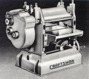

First, a little bit of history. Parks 12” planers were manufactured as early as late 1936, or perhaps slightly earlier, until 1989 when Parks Woodworking Machines went out of business. Our first evidence, in print, of the 12” planer is its inclusion in an undated Parks Catalog No. 37, which we think was published on or about 1937. Next, we have an undated Parks Heavy Duty 12” Planer brochure that includes a copy of a letter dated Nov. 1, 1938, from a satisfied customer stating that they “have had the planer in constant use for the past two years.” That would place manufacture as early as late 1936. To further place the origin of the planer in the late 30’s, we know that Sears included the planer in its 1938 catalog. Sears continued selling the planer through 1959. In the 1960 Sears catalog the Parks planer was replaced by the Belsaw planer-moulder. Although the Sears catalogs have been a helpful resource, one problem with using Sears Catalogs to identify changes is that there were no catalogs produced for the years 1944-1947 due to WWII. So when something shows up in the 1948 catalog it actually could have been several years earlier.
c.1939 Parks Brochure
1938 Sears Catalog
Mechanically, it appears that there were no differences between the Parks and the Craftsman planers. Cosmetically, the only differences between the Parks and the Craftsman appear to be that Craftsman Planers had Craftsman logo and model number tags rather than Parks tags, and the Craftsman Planers were painted a bluish grey rather than the plain grey of the Parks. Also, the Craftsman planer only came in the basic model, without a stand or motor (same as a Parks Model 95). In 1956 Sears began offering a 12 gauge steel stand and belt guard as options. With those two options the Craftsman planer would be identical to a Parks Model 97. There were six model versions of the Parks planer. The No. 37 Catalog shows only the Model 95, the basic bench-top planer without motor or stand. The c. 1938 Parks Heavy Duty Planer brochure includes the 95, the 96 which is a direct drive version, and the 97 which is a 95 with a stand and motor, later to include a belt cover. A 1952 Parks Planer-Jointer brochure and parts list includes the 95, 96, 97 and the Models 10 & 11. The Model 10 is the planer-jointer combination machine and the Model 11 is the same with a stand and motor. The 10 & 11 may have shown up earlier than 1952; that is just the first printed evidence I have uncovered. And finally the Model 98, a belt driven planer with a rear mounted motor appeared in a 1984 Parks catalog, according to Dana Batory in his book, Vintage Woodworking Machinery, Volume Two.

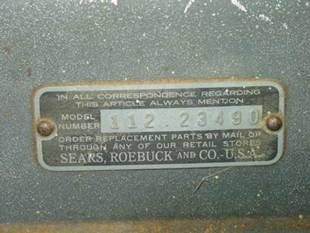

There were/are at least three different model numbers for the Sears badged planers: 112.1901, 112.23490 & 112.23491. I have yet to establish a reason for the three distinct numbers. The 112.1901 model was the earliest, the 112.23490 next and the 112.23491 the final model. At some point we may be able to establish a correlation between the model numbers and time or changes in the machine, but a correlation is not evident at this time. The Parks Model 97 Planer was sold with three different stands as time evolved. The first stand was a very graceful cast iron stand with sides that flared out toward the bottom. Later the planers had a cast iron stand with straight sides that sloped out towards the bottom. Later stands were also sloped and straight sided but made of fabricated sheet steel. Sears offered the fabricated sheet steel stand beginning in 1956 according to their catalogs.

As you will note from the above pictures, several major changes are apparent in the 1938 Sears Catalog photo. The frame is now clearly consists of three separate castings – two sides and a base. Although we do not know the reason for that change, we can guess that it was done because it was easier and perhaps cheaper to cast the three separate pieces than one very complicated casting. The gearbox now came with a throw out lever to disengage the feed rollers. The table raising shaft no longer penetrated the left side of the base casting and the flat bar in front of the in-feed roller was gone. We know that the gearbox itself was originally cast iron, but at some point fairly early in its history it was changed to cast aluminum, probably because the weight of the CI gearbox caused excessive wear of the gearbox where it hangs off the cutter head shaft. We have identified three versions of the gearbox cover. The original snap-on cover, as seen in the above picture in Catalog No. 37, was in use until sometime between 1943 and 1948 when it changed to a bolted on cover according to Sears Catalog art work. If the Sears’ art work is reliable, then it appears the multi-hump cover changed to a single hump cover sometime after 1959 when it last appeared in the Sears Catalog. I have heard one or two reports of a cast aluminum gearbox cover, but have not confirmed that an aluminum cover was ever made.

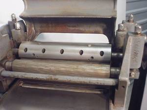

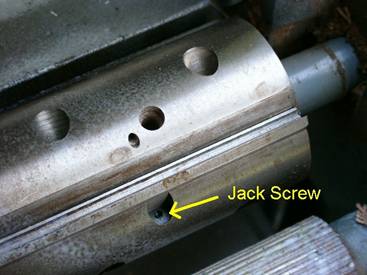

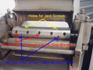

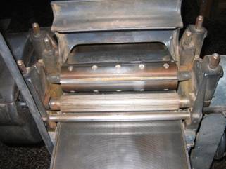

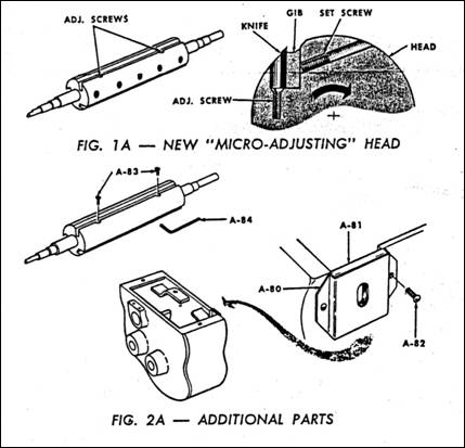

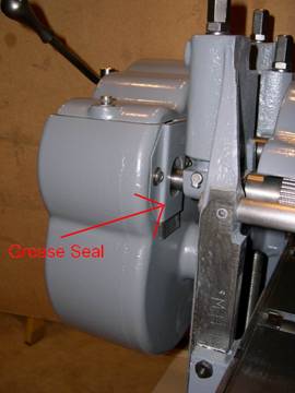

By 1957 the cutterhead had been modified to include jack screws to improve adjusting the knives. The first evidence we have of that is it being noted in the 1957 Sears Catalog that the “planer now has cutter heads with jack screws for micro adjustment.” That may also be the time when the gearbox got a grease seal at the in-feed roll.
Original Cutter Head w/o Jack ScrewsLater Cutter Head w/ Jack Screws
Drawing From late 50's Craftsman Operating Instructions & Parts List
Close Up of Jack ScrewGrease Seal at In-feed Roller

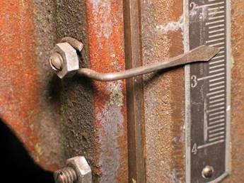

There are at least two variations of the depth of cut pointer – a bent steel wire or rod version and a bent flat aluminum version. At this point we don’t have enough information to know if the pointer is significant in the time line. However, based on a limited number of planers surveyed to date it appears that the steel pointers were used on early machines, to approximately serial number 5,000.
Flat Aluminum PointerSteel Pointer

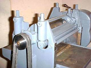

The table gib screws and lock nuts have several variations as do the hex adjustment nuts on the roll bearing and pressure bar studs. With a limited amount of data, it appears that earlier planers had 1” tall hex nuts and later machines (those with serial numbers approx. 30,000 and higher) had shorter (5/8”) hex nuts.
Tall Hex NutsShort Hex Nuts

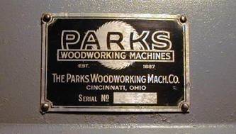

There are several variations in the badging (logo and model number tags) of the Craftsman planers and of the Parks planers. Parks nameplates were typically a 2” x 4” aluminum tag with red and black on silver, or black on silver. Some planers have a metallic sticker of the same size instead of an aluminum tag. So far, when we have seen the metallic sticker it included the serial number stamped on it. It appears that the metallic stickers may have arrived at approximately the same time as the short hex nuts, at about serial number 30,000. Sears badged planers typically had a Craftsman logo tag and a Sears model number tag. The Craftsman logo tag was usually found on the front of the base and the model number tag on the rear of the base. Sometimes the logo tag was on the top of the planer and then the model number tag would be found on the front of the planer. There were two years (1942 & 43) in which the Sears Catalog showed the planer without a logo plate, but it sported the word CRAFTSMAN in large painted block letters on the front of the base and the model number tag was on the rear of the base. Of all the Sears catalogs, only the 1955 catalog shows the Craftsman logo plate on top of the planer, but it may have been on the top in earlier years if earlier Sears Catalogs were using old art work.
Typical Aluminum Parks Tags
Metallic Parks Sticker w/ Serial No.

Sears Model Number Plates

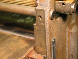

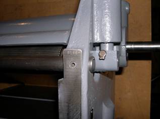

Serial numbers can usually be found on the upper front machined face of the right side casting on both the Parks and Craftsman planers. However, some Parks badged planers had the serial number stamped on the Parks nameplate or a metallic sticker and not in the frame. We have noted a few planers without serial numbers, perhaps only because the nameplate was missing.
Most Common Location of Serial number - Stamped on Frame

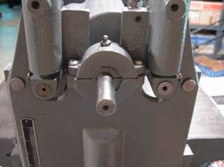

Somewhere in the life of the planer the cutter head bearing caps were strengthened by thickening the ears on the cap.
Original Bearing CapStrengthened Bearing Cap
