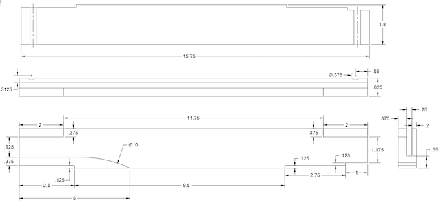

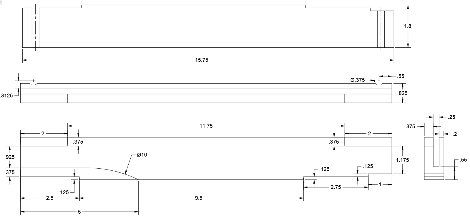

I made a new wood guard for the left side of the common 14" band saws. I thought this information would be useful since it is a fairly easy part to recreate. All dimensions are in inches. Picture scale is 3:4
