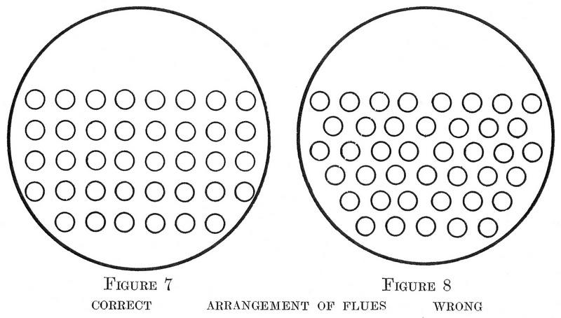

      The Arrangement of Flues — The arrangement of flues in a boiler is an important matter and in past years some mistakes have been made by manufacturers in arrangement. At the present time, so far as known, the arrangement of flues in direct flue boilers is in both horizontal and vertical courses, as shown in Figure 7. This arrangement is much better than shown in Figure 8, in which the flues are staggered in vertical rows. Such an arrangement impedes the circulation and does not allow the scale to drop to the bottom, while at the same time such arrangement makes the boiler very difficult to clean. It is just as essential to have good circulation in a boiler, so far as steaming qualities go, as it is to have plenty of heating surface; in fact, this is another principle in correct design.
Figures 7 & 8
Figures 7 & 8

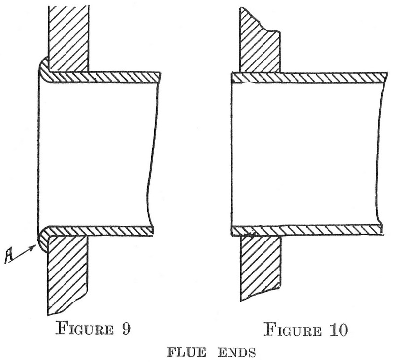

      Flues are secured in the flue sheets by being expanded at the ends and then beaded over at both ends, or else by being simply expanded at one end and expanded and beaded at the other. Figure 9 shows a tube expanded and beaded and Figure 10 a tube simply expanded. Both methods are in common use and have been for a good many years and both have proven satisfactory in practice.
Figures 9 & 10
Figures 9 & 10
      Tests made on the holding power of beaded flues and flues that are simply expanded in the flue sheets show about the same results. It would seem as though the beaded flue ought to hold a good deal more, but the tests show very little difference. Where flues are beaded care must be taken to make the bead, especially in the firebox end, as small as possible. If it is made large it is almost sure to be poorly formed, thus making a poor joint between the flue and flue sheet, as shown in Figure 11. Or even if well formed, the large mass of metal in a big bead, being so far away from the water, does not conduct the heat rapidly to the water and, hence, is pretty sure to become burned before it has been long in use. Quite a good deal of the difficulty experienced with leaky flues arises from just this cause.

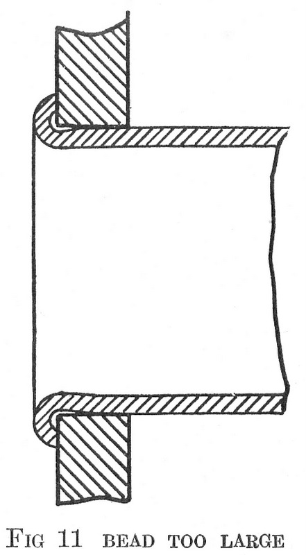

      A great many manufacturers, both of traction engines and locomotives, place a copper ferrule between the tube and tube sheet in the fire box end. When the tube is expanded, the copper being much softer, fills whatever little inequalities there are between the two surfaces and thus makes a tight joint. Furthermore, since copper expands very much more than iron for the same increase in temperature, it follows that the joint will be tighter when the boiler is steamed up than when cold. This is the reason why boiler tubes will sometimes leak when cold and be perfectly tight after the boiler is steamed up. The one objection to the use of copper ferrules is the fact that the alternate contraction and expansion of the metal finally presses the copper out of shape and makes a leaky joint.
      Where the holes for the tubes are reamed perfectly true and the flue is turned to a perfect fit, so that bright surfaces come in contact, a very satisfactory joint can be made without the use of copper, but however made there is bound to be more or less difficulty with leaky flues, due to the fact that they are made of thinner material than the flue sheets and consequently expand and contract rapidly with sudden changes in temperature.

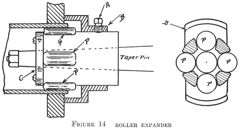

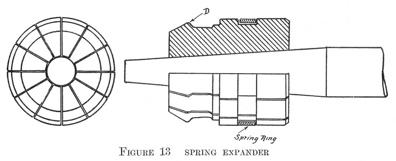

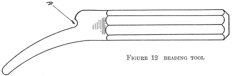

      Figures 12, 13 and 14 represent the tools used for putting in flues. Figure 12 is a beading tool, 13 a spring expander, and 14 a roller expander. Every engineer ought to have a beading tool, which any good blacksmith can make, in his tool box. In making this, care should be taken to make the radius of curvature at A of the right size, because the size of the bead on the tubes will be dependent upon the size of this curve. Either one of the expanders will do good work. For repair work, where the holes in the flue sheet may be slightly out of round, the spring expender will probably do the better work; for new work, the roller expander is very satisfactory.

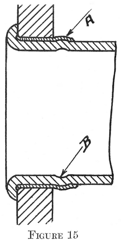

      In putting in flues care should be taken, first to anneal the ends, which can be done by heating them to a bright cherry red and then allowing them to cool in slaked lime, dry ashes or dry sand. They should be cut off square on the ends, preferably in lathe, and an allowance provided of between one-eighth and three-sixteenths of an inch at each end for beading or for projection if they are not beaded. After the tubes are in position the expander is driven in fairly tight, the taper pin is then jarred loose, the pin turned slightly, then driven in again, and this operation repeated until a tight joint is secured between the tube and tube sheet. Care should be taken not to drive the expander in too tightly, as by so doing the flue may split or the adjacent flues be caused to leak, due to a deformation of the tube sheet.
      The work done by the spring expander whose operation has just been described is shown in Figure 15. The convex portion at A forms the groove shown at B in the figure. After the tubes are expanded the bead is generally started with the ball-peen of a machinist’s hammer and then finished up by means of the beading tool. In using this, care should be taken that the sharp edge does not gouge into the tube sheet. Leaky flues can be cured sometimes by simply using the beading tool, and almost always by using the expander.

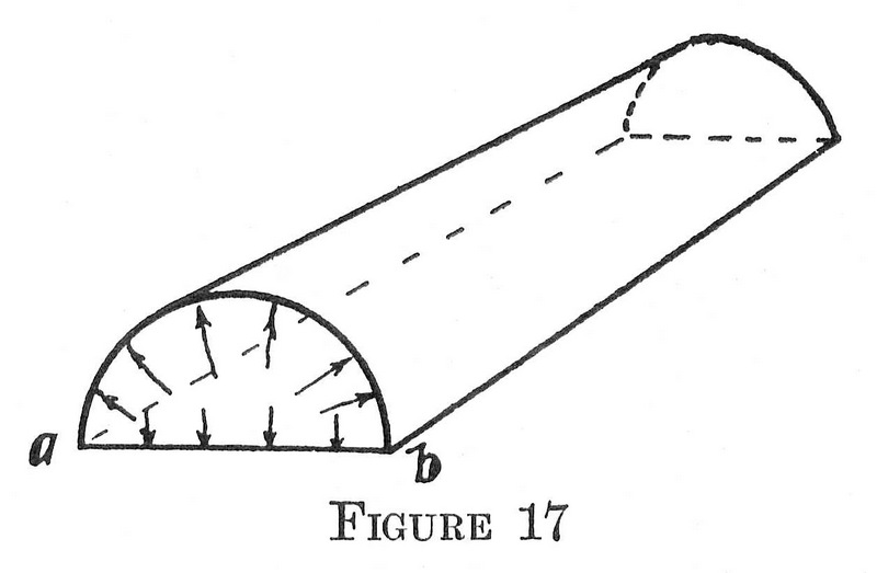

THE STRENGTH OF BOILERS
      Most of us have seen formulas in text books for finding the safe working pressure in cylindrical boilers, and we may have wondered where they came from and how they were obtained. It may therefore interest some of the readers to work out one of these formulas from the beginning.
      In the first place, we will consider a cylindrical boiler, made up without joints or seams, that is, with the joints welded together making a seamless tube, and with the heads welded in place also. If such a boiler should burst, it is easy to show that it would be more apt to split along the side than to blow the head off. We will suppose the whole boiler to be made of soft steel having a tensile strength of sixty thousand pounds per square inch. Which means that if we had a piece of such steel, one inch square, it would require a force of sixty thousand pounds to pull it apart.
      Example — Suppose we have a boiler 96 inches long, 30 inches in diameter and made of steel ¼ inch thick. If this boiler is under steam pressure, it is a well known fact that the pressure acts in every direction from the center outward, and its tendency is to separate the shell into two parts. The total force tending to pull the two halves apart will be equal to the force exerted on the flat plate a-b of Figure 17, because the force acting upward on the curved upper half must exactly equal the pressure on the flat plate, otherwise the boiler would move, which of course it will not do. The total downward pressure on the flat plate can be easily figured. The area of this plate is 30×96=2,880 square inches. If the steam pressure is 100 pounds per square inch, the total pressure on the plate is 2,880×100=288,000 pounds. The metal holding this plate to the upper half is the metal along the edges a-and-b. In order for the plate to separate from the curved part the metal must tear apart at a-and-b throughout the entire length of the shell. The area of this metal is 2×¼×96=48 square inches.
Figure 17
Figure 17
      Under the given conditions 48 square inches support 288,000 pounds, consequently each square inch is subjected to 288,000÷748= 6,000 pounds per square inch, or just one-tenth of what it would require to tear the metal apart.
      If each square inch of metal were subjected to 60,000 pounds the total force acting on the flat plate would be 60,000×48=2,880,000 pounds, and since the area of the plate is 2,880 square inches the pressure within the boiler to cause the rupture would be 2,880,000÷2,880=1,000 pounds per square inch. We can now proceed to find a formula for finding the bursting pressure of any boiler.
Let: T=60,000 P=bursting pressure D=diameter of boiler in inches Z=length of boiler in inches t=thickness of boiler plate in inches
Then P=(60,000×2×t×Z)÷(D×Z)
      But since the Z appears both in the numerator and in the denominator it cancels out and our formula reduces to a simpler form as follows.
P=(60,000×2×t)÷D
      This, remember, represents the bursting pressure, theoretically, of a boiler without seams or joints. Since it is usual to put in a factor of safety to find the safe working pressure we will use the factor 5, or in other words, divide the result obtained from the above formula by 5. The result obtained in using the formula for example given was 1,000 pounds, which divided by 5 gives us 200 as the safe working pressure for a boiler without joints or seams.
      Putting the factor in the formula we have:
P=(60,000×2×t)÷(5×D)
      But boilers are riveted and if the side seams are double riveted, as is the usual case, the strength of the seam is only 70 per cent of the rest of the shell, so that the safe working pressure of the above boiler with a double riveted joint is 70 per cent of 200 or 140 pounds. Inserting this factor in the formula we have: The safe working pressure of a cylindrical boiler, having double riveted side seams. Expressing this in a formula we have:
P=(60,000×2×t×70)÷(5×D×100)
      Assembling all the figures and putting them in the formula:
(60,000×2×¼×70)÷(5×30×100)=140 pounds (per square inch) safe working pressure.
      If the boiler is 40 inches in diameter and the thickness of the plate is the same, the safe working pressure is:
(60,000×2×¼×70)÷(5×40×100)=105 pounds (per square inch) safe working pressure.
      This shows that if we increase the diameter of the boiler it will not stand so much steam pressure, unless we increase the thickness of the boiler plate a corresponding amount. In other words, the larger the diameter of the boiler the weaker it is, with the same thickness of plate.
      In the fore part of this lesson it was shown that, with 100 pounds (per square inch) pressure in the boiler, each square inch of metal along a side seam was subjected to a stress of 6,000 pounds. We will now consider the stress on a circumferential seam, that is, to prevent one of the heads from blowing out. The area of a 30-inch boiler head is 3.1416×15×15=706.86 square inches. If the pressure is 100 pounds per square inch the total pressure on the head is 706.86×100=70,686 pounds. In order for the head to blow off it must tear the metal all around the boiler. The length of this strip of metal is equal to the circumference of the boiler, or 3.1416×30=94.248 inches. Its thickness is ¼ of an inch, and the area of the metal that must be ruptured is 94.248×¼=23.562 square inches.
      Dividing 70,686 by 23.562 we obtain the quotient 3,000 which represents the stress on each square inch of metal on a transverse seam, but this is only one-half what it is along a side seam; thus showing that a boiler is much more apt to fail by splitting along the side than it is to blow the end out. This also explains why side seams are double riveted and transverse seams single riveted.
