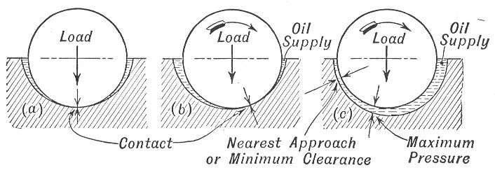

In order to achieve this low level of friction, bearings must be properly lubricated. Under ideal conditions, the motion of the rotating shaft over the babbitt surface will draw in whatever oil may be present, which builds up a thin film according to the laws governing the flow of fluids.
As an example of how this works, when the shaft is still and not rotating, the entire load of the shaft is making contact with the bearing surface. Ideally, at this point, there will be oil in the bearing, which will be surrounding the shaft on either side of the contact point.
As the shaft begins to turn, oil from around the bearing will be pulled under the rotating shaft until there is a wedged-shaped film of oil completely around the shaft. If conditions are right and adequate lubrication is present, the shaft will actually be floating on a thin film of oil and will not come in contact with the bearing material, resulting in an extremely low coefficient of friction.
Fluid Film Lubrication
If there is not enough oil to create this film of oil, or if once formed it breaks down due to insufficient speed, poor oil viscosity, insufficient oil or excessive load, there is usually enough oil present to wet the surfaces and prevent high friction coefficients. In this situation, it is not uncommon for the bearing to get warmer than one would like but this will usually not cause great problems.{Reference:The Elements of Machine Design. By S. J. Berard and E. O. Waters. Published by D. Van Nostrand Company, Inc., New York., Second Edition, 1932. Pp. 166-168}
