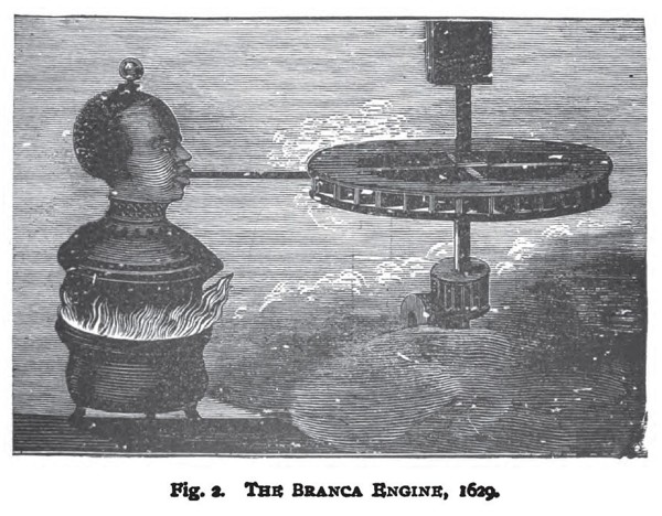

 The Branca Engine |
     Giovanni Branca, of Lorreto, Italy, in the year 1629, produced a machine combining an engine and boiler, the power from which was derived from the expansion of water into steam. Branca, in his writings, claimed that much useful labor could be accomplished through his device. There were other inventors in the field in the early part of the same century in which Branca lived, but the machines and contrivances to utilize the energy known to be locked up in steam, never (like the one illustrated, Fig. 2), amounted to much more than idle dreams.

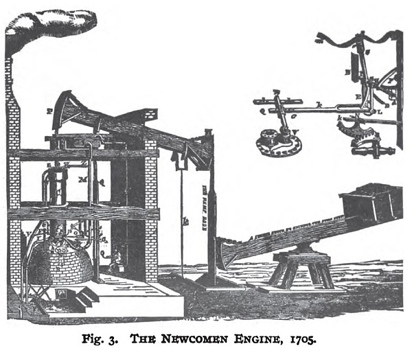

 The Newcomen Engine |
     Fig. 3 illustrates the Newcomen engine, which was patented in 1705. Our space is too limited to go irto a detailed statement of its method of action, except we may say that the steam was let into the cylinder (C) a little above atmospheric pressure, and by its elastic force raised the piston, and the stroke was completed by the condensation of the steam which produced a vacuum and allowed nearly the full pressure of the air to accomplish the desired result of raising the water.
Note.—
One of the Newcomen engines was erected in Holland to aid in draining a lake near Rotterdam. The following were the extraordinary dimensions: Cylinder 52 inches in diameter; stroke 9 feet. The boiler was 18 feet in diameter, and contained 2 flues; but 60 years later engines with 12 feet diameter of cylinder and i0 feet stroke were erected in Holland to do similar work. It was the Newcomen form of engine that Watt and Trevethick found in general use when they began their improvements.      Between 1765-74, John Smeaton devised a succession of improvements in the atmospheric engine, and carried it to its utmost perfection; in these days it was still named the fire engine. The force was exerted in but one direction, and could not exceed the atmospheric pressure, in fact, was even short of this, for the vacuum was far from being complete.

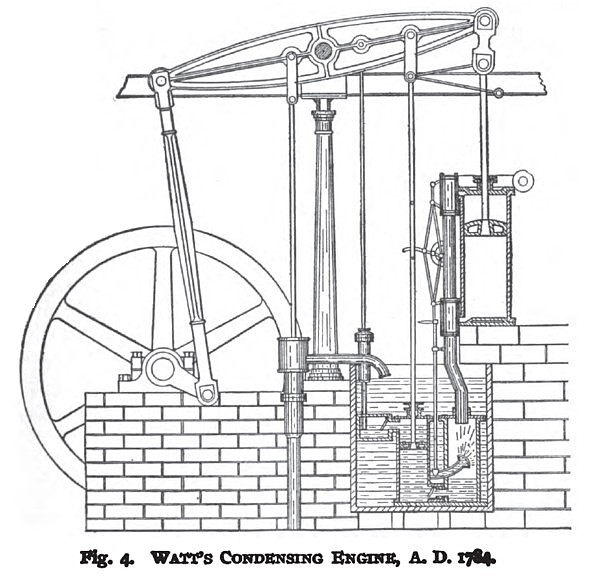

 Watt's Condensing Engine |
      Fig.1 is a very rare imprint of the immortal designer and inventor of the modern steam engine and its invaluable adjunct, the Indicator. Fig. 4 represents Watt's Condensing Engine.

By the year 1784, Messrs. Boulton & Watt had brought their engine to a position where it combined all the devices which Watt had either improved from old models or clearly invented himself. There were a pair of their engines erected in London, in this year of sufficient power to drive twenty pairs of millstones. In these engines were to be found the newly applied fly-wheel, the glass water-gauge, the mercury steam gauges, "fly ball" governor, the poppet valve with beveled seat, the cross head and guides, and many minor improvements covered by Watt's numerous patents.Information Sources
