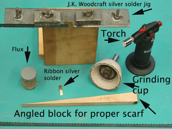

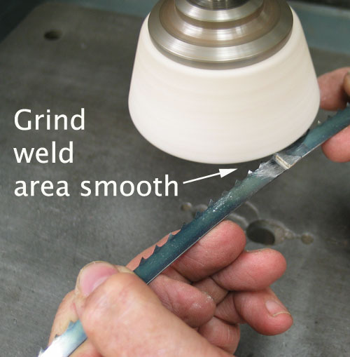

Naturally, blades joined in this manner won't worn on NWWM :-) The JK Woodcraft jig shown is a prototype from 1987. The newer ones are galvanized and don't rust up as easily.

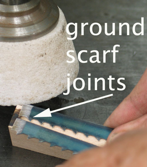

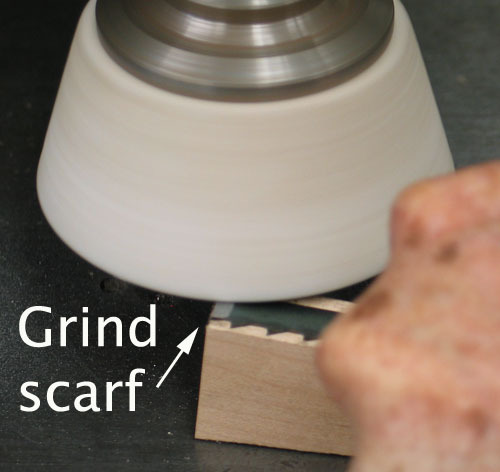

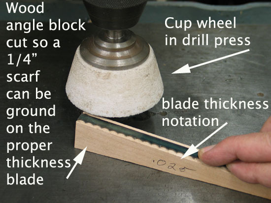

How you grind the scarf joint is up to your using what faculties you have. I like this rig better than any other I've tried because it keeps that thorny snake of a bandsaw blade off my shoulders and more at my feet.

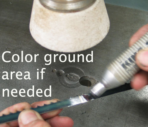

Not shown is what to do if there's ticking as the blade runs through the guides from a high spot. Color the blade with a felt tipped marker, roll the blade through a few revolutions, observe where the color has worn away and get out the dremel and grind down those spots.
Components
Components
Grinding Block
Grinding Block

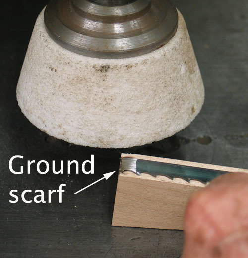

Grind Scarf
Grind Scarf
Ground Scarf
Ground Scarf
Ground Scarf Joints
Ground Scarf Joints

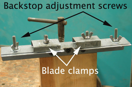

Holder
Holder
Clamp to bench
Clamp to bench

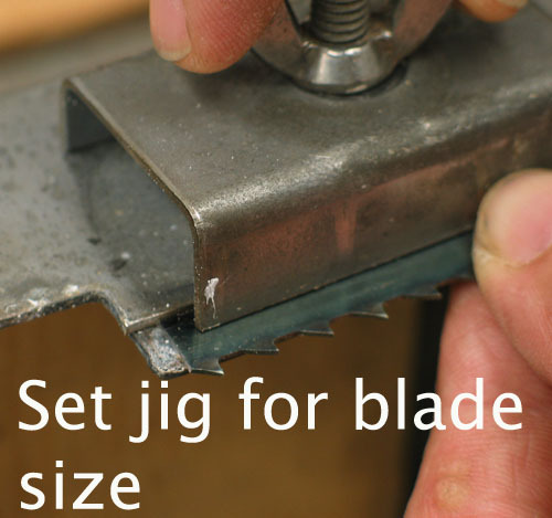

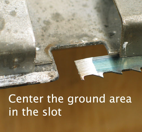

Set jig for blad size

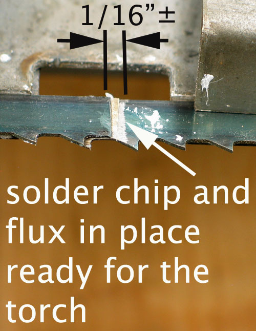

Center the ground area in the slot

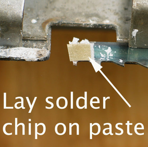

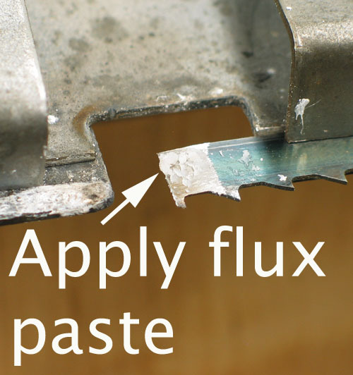

Apply Flux
Apply Flux
Apply Solder
Apply Solder
Ready for the torch
Ready for the torch

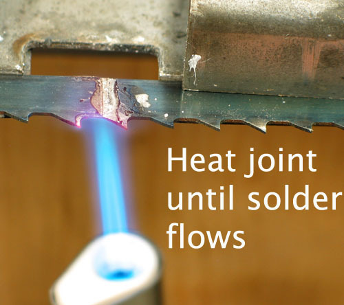

Heat Joint
Heat Joint

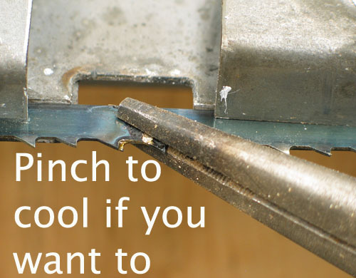

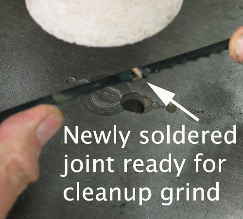

Cool joint
Cool joint
Get ready to grind
Get ready to grind
Grind
Grind
Color ground area
Color ground area
