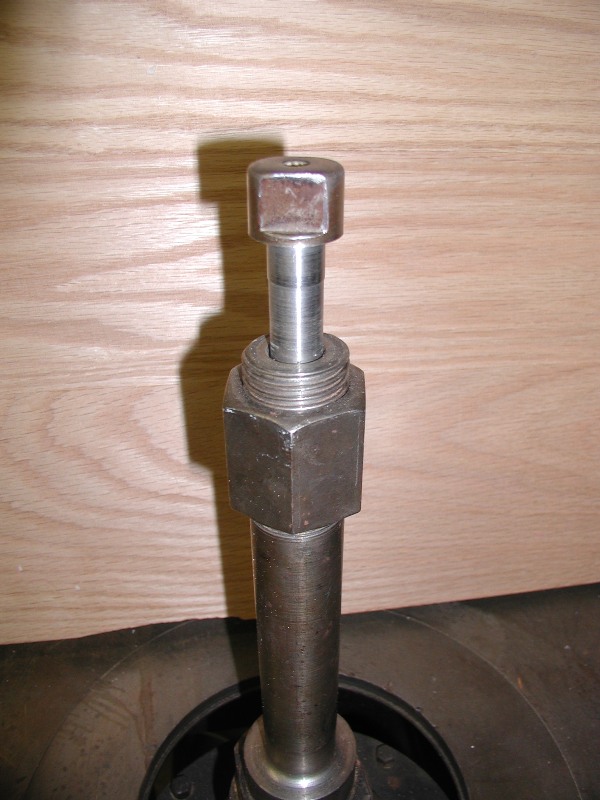

First, to remove the rollerhead from the yoke back out the king bolt set screw. The king bolt can then be unscrewed from the locking arm and removed.
Here is the king bolt assembly. When you reinstall it, the set screw should engage in one of the milled recesses in the king bolt.
