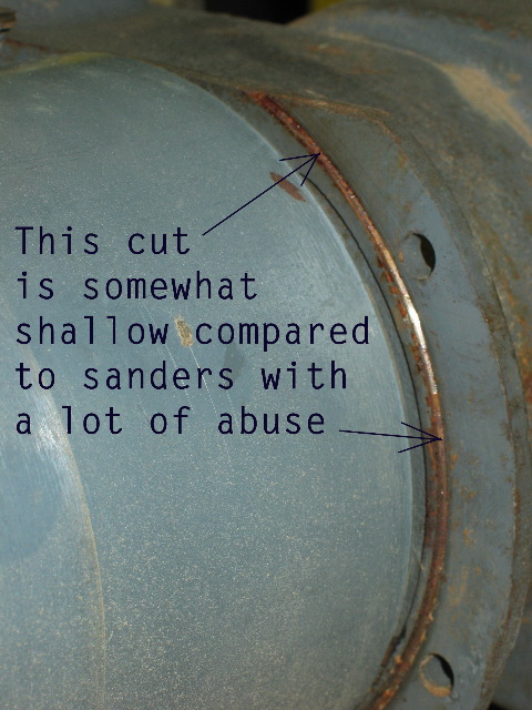

These details show various problems one can encounter when buying a used sander
belt sander body details.
Table and inside groove:
Lower sanding cut:
