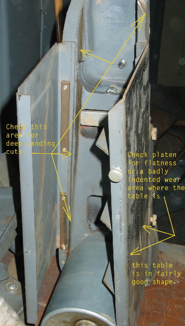

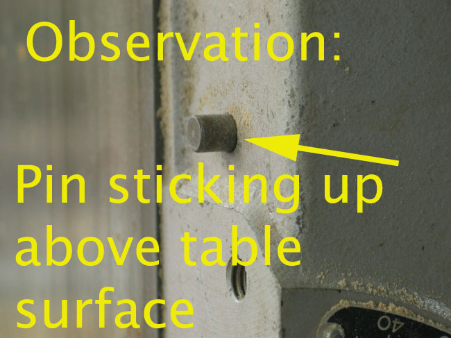

These details show various problems one can encounter when buying a used sander{Reference:http://www.owwm.com/photoindex/detail.aspx?id=3717|belt sander body details}.
Table and inside groove:
Lower sanding cut:

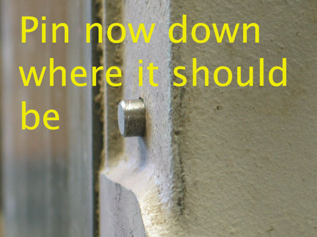

Tightening Screw Repair
By Bob Vaughan{Reference:http://www.owwm.org/viewtopic.php?t=41918|Delta 6x48 31-730 sander repair details(16 pictures)}

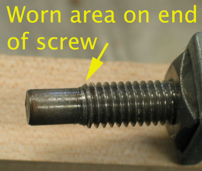

Another problem point is that the end of the tightening screw wears where the threads rest against a shoulder in the casting. This causes the end to stick up above the bed and becomes a nuisance.

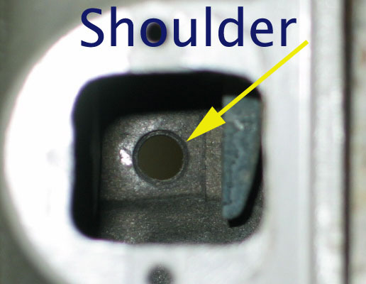

The shoulder in question inside the casting

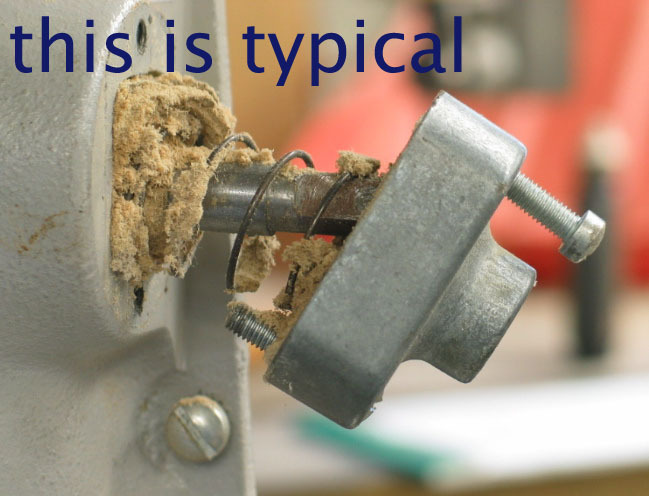

Typical of any sander disassembly
The bad shoulder

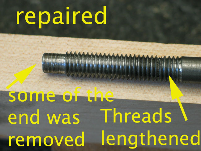

Turning the shoulder down a bit. Also, the end was turned back that amount and a little taken off the housing shown two photos up.
All Better
