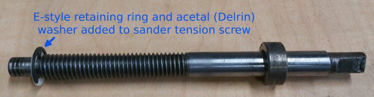

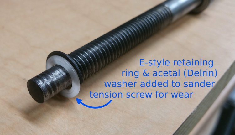

Tension Screw Repair
By bullmastiff
It was my wife's fault: 1952 Delta 6x48 Belt Sander, mostly
This is an alternative to the solution presented below to the problem of the tension screw wearing against the inside of the casting, allowing the end of the tension screw to protrude past the plane of the platen and get in the way of sanding. The
By Bob Vaughan
Delta 6x48 31-730 sander repair details(16 pictures)
Another problem point is that the end of the tightening screw wears where the threads rest against a shoulder in the casting. This causes the end to stick up above the bed and becomes a nuisance.
The shoulder in question inside the casting
Typical of any sander disassembly
The bad shoulder
Turning the shoulder down a bit. Also, the end was turned back that amount and a little taken off the housing shown two photos up.
All Better
