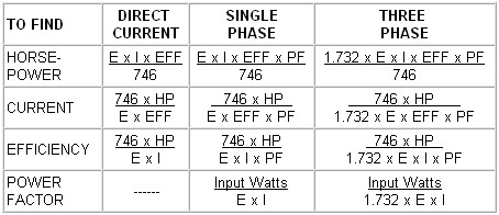

Electrical Calculations
The term horsepower is used extensively when describing the size of electric motors on OWWM. So, what exactly is a horsepower? For our purposes, one horsepower also equals 745.699 watts or .746 kW (kilowatts) of electrical power. We round this off to 1 horsepower = 746 watts.
Where:
  • E = Volts
  • I = Amperes
  • EFF = Efficiency (decimal)
  • PF = Power factor (decimal)
  • HP = Horsepower
Single Phase Motor
Example: What is the actual horsepower output of the following motor if its actual measured current draw is 16 amps?
5 HP, 230 Volts, FLA 20.72
Eff(%) 0.86, PF 0.91, SF 1.15
HP = (E x I x EFF x PF) / 746
HP = (230 x 16 x 0.86 x 0.91) / 746
HP = 2880 / 746
HP = 3.86 Hp
Three Phase Motor
Three phase motors use the same calculation as was used on single-phase motors with one addition to the formula. Three phase motors have three separate voltages each 120 degrees out of phase from one another. This is what gives the three phase motor its superior starting and running power and eliminates the need for start capacitors and start relays to remove a starting winding as is often necessary on single phase motors.
The three-phase motor is 73% more powerful than an equivalent single phase motor of the same voltage and amperage. The is reflected by the factor 1.732 in the equations below. The factor 1.732 is the square root of the number 3 representing the 3 phases.
Example: Prove that the actual horsepower output of the following motor is the same as the manufacturers specifications at FLA?
1 HP, 230 Volts, FLA 2.8
Eff(%) 0.84, PF 0.82, SF 1.25
HP = (E x I x EFF x PF x 1.732) / 746
HP = (230 x 2.8 x 0.84 x 0.82 x 1.732) / 746
HP = 768.293 / 746
HP = 1.03 Hp
