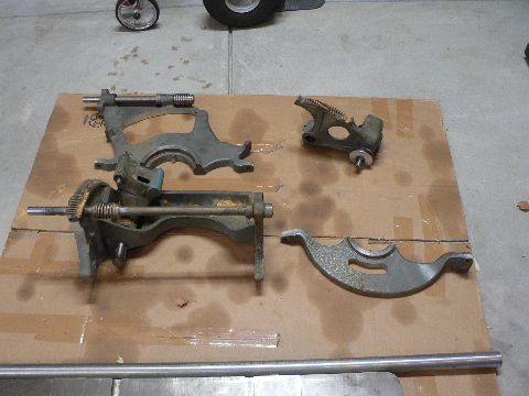

The next step is to remove the hex head cap screws holding the Front Trunnion Bracket and Rear Trunnion Bracket to the top of the saw cabinet. Your first thought will be that all the castings will come crashing down into the cabinet but things are tighter than that and you will be able to remove the screws while everything remains suspended. It doesn’t hurt to have an extra pair of hands but you can remove the combined assembly of these parts all by your lonesome. The procedure is to swing the assembly made up of the Front Trunnion Assembly, Yoke and Rear Trunnion Assembly and let it slide along the half moons (Trunnions) of the now loose Front and Rear Trunnion Brackets. It’s that simple and as easy as eating pie.
Trunnion Assembly Removed
Take the now removed assembly and place it on the bench or in a parts bin if you have one large enough. Return to the saw and pluck the Front and Rear Trunnion Brackets off the saw cabinet rim before you bump the cabinet and cause them to come crashing to the ground.
Front and Rear Trunnion Brackets Removed
All Apart!

Step 5. Relax and smile. Enjoy the fact that you just got those things out of there and realize that in a few days/weeks/months you'll need to reverse the process to put them back in just so. Here is what they will look like sitting in your shop at this point.
Unisaw guts removed intact

From here it’s a matter of studying the parts against the parts drawings and becoming familiar to what Herbert Tautz had in mind when Delta was designing the Unisaw. It’s all pretty simple but I’ll go over a thing or two.
The Front Trunnion Assembly, Yoke and Rear Trunnion Assembly will all need to be taken apart. The Front and Rear Trunnion Assemblies are held to the Yoke by hex head cap screws and are located with dowel pins. You’ll remove the cap screws but the parts probably won’t come away from each other. Use a dead blow or rubber mallet to separate these parts. A little Marvel oil will go a long way and you should not wail on these parts.
Trunnion Disassembled
Base Removed
At this point in time you’ll be looking at parts bins full of parts, assemblies and baggies with the itty-bitty parts and pieces. What I like to do is start cleaning by assembly. This way you only need to keep track of those parts and pieces and won’t find yourself later trying to remember what went where and why. Don’t Ask Me How I Know This.
You might be tempted to try and remove the brass bushings from the Front and Rear Trunnion Assemblies but I’ve never seen a need for this. Partly because I’ve never found them that critical to clean, they don’t wear that badly and I was plain afraid of cracking the castings trying to remove them. Speaking of cracked casting, never force parts beyond what you feel comfortable with. Most parts are a press fit and a little Marvel oil is usually all you need to help with freeing up a piece. A cracked casting, especially if it becomes cracked by your stupidity will pretty much ruin the best of days.
