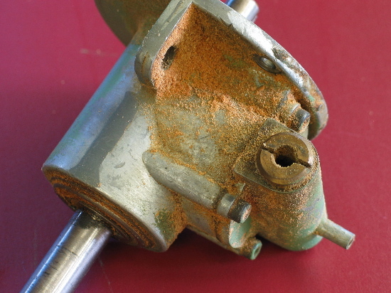

Here's the pump area looking up into the bottom air intake area. Remove the 4 screws holding on the pump housing. Image

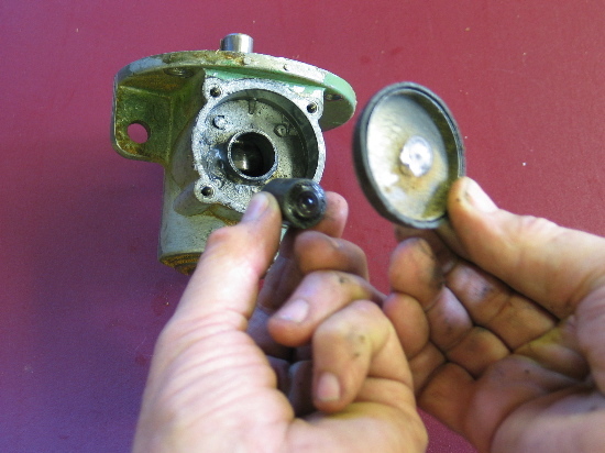

Here's the pump diaphragm and push block that works against a cam in the shaft. Inspect for wear. Image

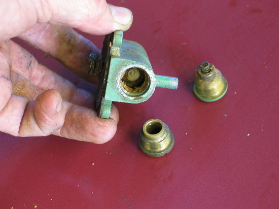

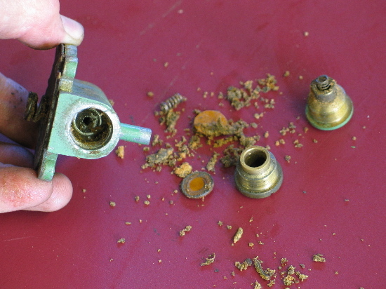

Remove the two end plugs. Be careful here as there are some very whispy light springs in there. Image

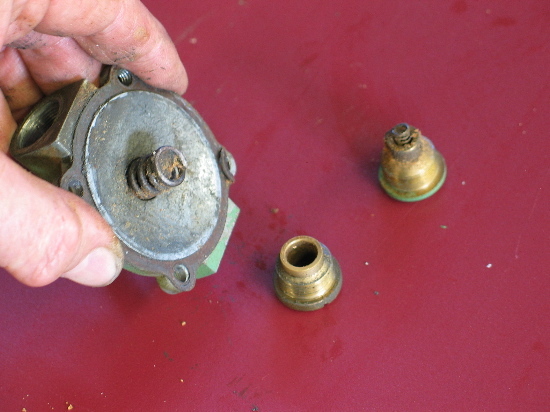

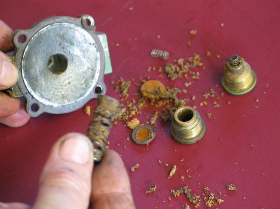

Here's the diaphragm spring that keeps tension on the steel/leather diaphragm. Image

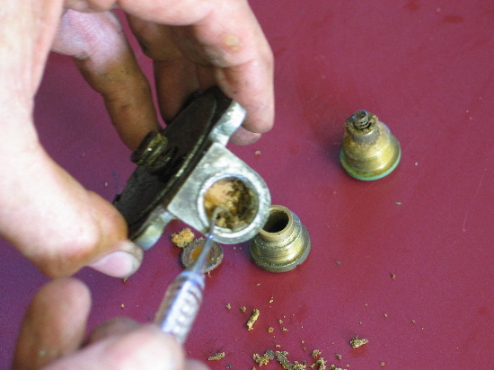

A dental pick is being used to clean out all the grease and impacted sawdust around the valve seat. Image
Here's the whole mess typical of 20 years of use. Image
A diaphragm return spring that was pretty dirty Image

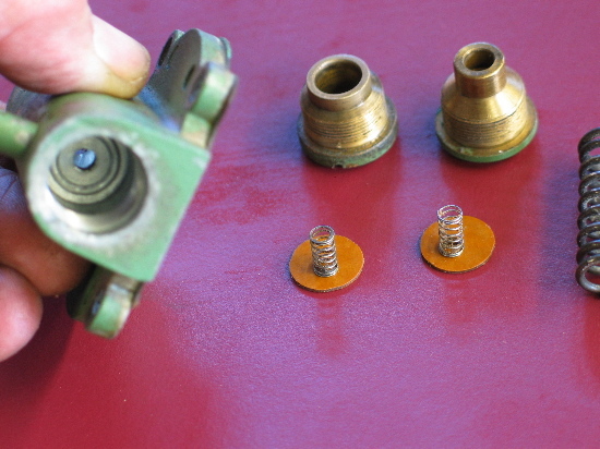

All better now. Cleaned flapper valve return springs, clean phenolic valves, and cleaned end caps. Image

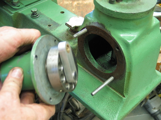

For re-installation, I'll run a couple pieces of all thread to hold the position of the shaft housing so all things can be aligned and assembled to the lower plunger shaft. Image
