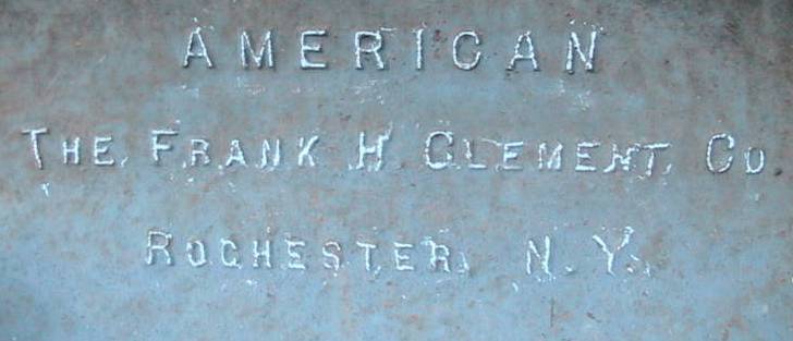

American machines have five kinds of markings on them.
First is the raised cast letters saying “American”.

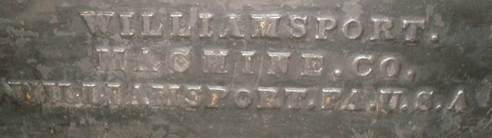

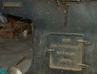

Another variation is a bolted on “American” and the original designers name cast in a main part of the machine.
Title
The dual tagging is much more prevalent on the earlier machines slowly having been phased out as American Established themselves as a name.

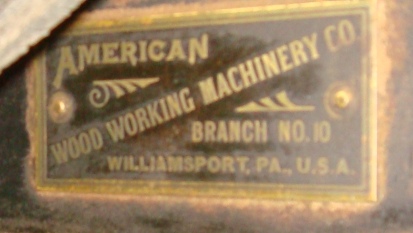

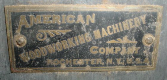

Second is the Angled badge:
Title
Title
This badge is can be in several forms and is the indicator of where the machine was actually made and not whose design (of the original 11 companies) it was.

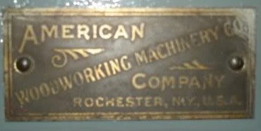

The Clement plant had an odd angle badge called the redundant badge because it says “Co. Company”. If your machine has this it is important to include that into the photo submission.
Title

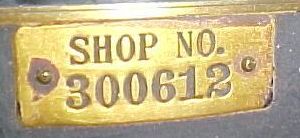

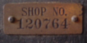

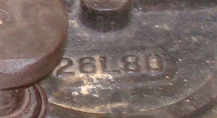

Third is the “SHOP NO.” tag. This is in effect the serial no. for the machine. AWWM did not do any other form of serial #’s that we know of.
Title
Title

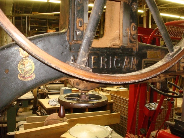

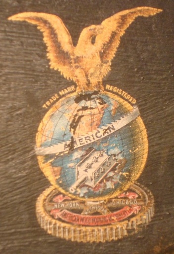

Fourth is the Eagle & Globe Badge:
Title

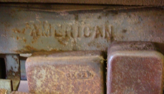

Fifth are the casting Part nos. They are nothing more than part numbers and appear on later machines.
Title
Occasionally you can find all these markings on a single machine. Usually band saws are like that.
Title
Now to the deciphering of “SHOP NO.” and origin of machine designs and later production locations.
With 5 and 6 digit “SHOP NO.” the first digit indicates the place of manufacture. It does seem to hold up for both 5 and 6 digit “SHOP NO.”. Four Digit “SHOP NO.” indicate very early machines. To date we know of no less than a 4 digit “SHOP NO.”.

From what I have gathered on the Angled badges the Williamsport plant went from "Woodworking" to "Wood Working" around the time they went from a 5 to 6 digit shop no.
