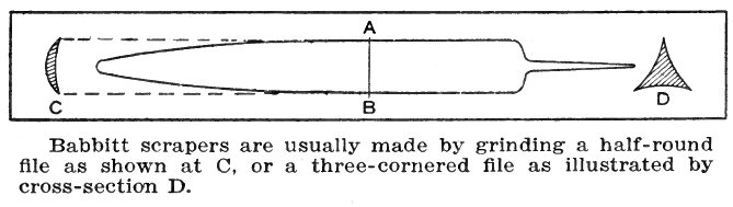

When everything is in readiness, the babbitt is melted in a regular ladle. In the absence of a proper instrument for taking the temperature, one must simply use good sense in heating the metal, not too hot, but hot enough that it will run freely into all parts of the box before it begins cooling. The temperature at which babbitt should be poured is about 450 to 460 degrees C. Pour the metal in a steady stream, being careful not to let any of the top slag enter the box and be sure to have enough metal to fill the entire box with one pouring. Do not disturb the newly cast box until it has cooled ; then take the boxes apart and smooth off all rough or sharp edges with a chisel or rasp, and babbitt scraper. Open the oil holes, and chambers if any, and cut oil channels from them to points near the ends of the box, as shown in Fig. 83. The function of the oil channels is to facilitate the flow of oil to all parts of the bearing, therefore, they should lead outward from the supply holes in the direction of rotation. Their edges and those of the boxes should be rounded because sharp edges tend to scrape oil off the journal and prevent its proper distribution.

Every babbitted bearing must be carefully scraped to fit its journal perfectly. Otherwise, the journal will bear only on high spots and all lubricant will be forced into the low places where it will not do any good. Under such conditions, overheating is certain to occur, even tho the bearing is flooded with oil. In order to know where to scrape, give the journal a very thin coating of red lead paint and turn it around in the boxes. The bright spots show where the surface must be scraped. When the fit between journal and boxes appears to be perfect, bolt the latter in place, put on the belts, and run the spindle up to speed for a few minutes. Take the boxes apart again, and the bright places caused by friction show exactly where to do the light, final scraping. This all takes time, but is worth it, because it produces smooth-running, non-troublesome bearings which are so essential to good molder work.
