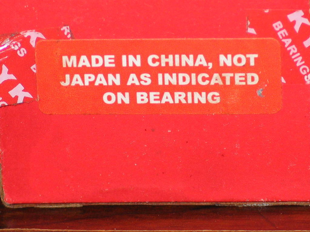

Purchasing Bearings
Numerous members have reported quality and durability problems with bearings made in China. Problems encountered include excessive noise, heat, and failure after short use. Many companies make/source some of their bearings in China, even though they are not Chinese companies. Thus when ordering, specifically requesting bearings from a non-Chinese company may not be sufficient. It is necessary to explicitly request bearings not made in China. This is a reflection of quality processes currently in place in factories in these countries, and the markets/price points these manufacturers are seeking.
Where is it Made??
Get at least a Nachi (Japanese) brand or better and you won't have to worry about what's going to happen in a couple of years. Nachi is a medium quality brand. Fafner, NSK, SKF, are all top of the line bearings.
Many folks feel that when they are going to all the trouble of tearing a machine down to rebuild or repair, that a few extra dollars spent on better quality bearings is well worth it.
On the other hand, so what if the bearings get a “short” life until failure, maybe they fail at 10,000 hours. How many hours are going to be logged on your machine each week in a one man shop? Even ten hours a week gives a lifespan of 1000 weeks, or nearly 20 years of service.
Bottom line is to make sure that the bearings you put in will provide the service life you require/expect. Going with slightly higher quality bearings will rarely yield an unhappy surprise. Going with slightly lower quality bearings will most often yield a fairly quick unhappy surprise.
