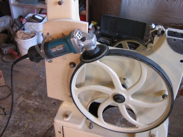

So here's what I came up with:

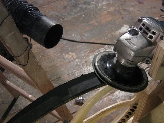

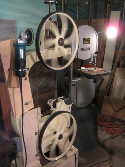

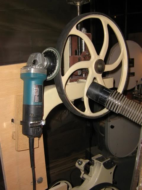

I used the tapped hole for the side handle, and a quick release pipe clamp to hold the grinder in the jigs. The jigs are attached to the frame by the same bolts that hold the cabinet and blade guard castings. One bolt is a pivot, and the jig has arc (for the second bolt) to allow the grinder to swing into the cut.

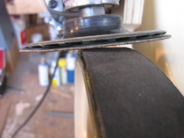

To get the angle for the bevels, I thought of several complicated ways to hold it, but just ended up eyeballing and shimming until each cut angle was set. That was the vast majority of the work. I also considered using a long carriage bolt to make a feed mechanism, so that I could control the depth of cut, but I just ended up tapping the jig with a hammer, and adjusting the tightness of the bolts to control the cut.
Oh yeah- I used a 60 grit disk on a backer pad.
And I could even check the crowning with a blade, without removing the jigs!
Despite my trepidation, it appears to have worked just fine. I almost managed to fry my angle grinder, not sure if I pinched it too hard with the pipe clamp and deformed the motor windings slightly, or if I shouldn't have been using a router speed controller. Thankfully, it worked fine after a cool down break
