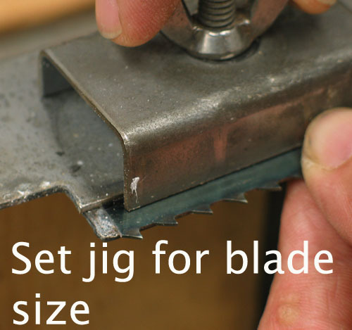

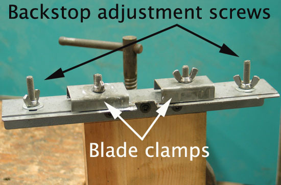

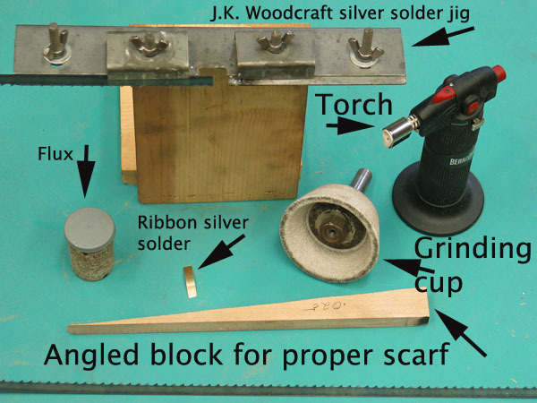

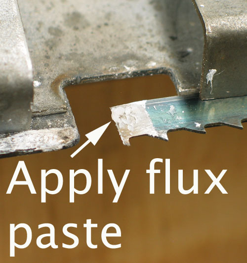

Naturally, blades joined in this manner won't worn on NWWM :-) The JK Woodcraft jig shown is a prototype from 1987. The newer ones are galvanized and don't rust up as easily.

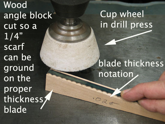

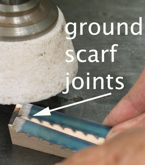

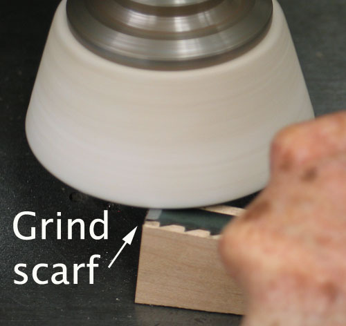

How you grind the scarf joint is up to your using what faculties you have. I like this rig better than any other I've tried because it keeps that thorny snake of a bandsaw blade off my shoulders and more at my feet.

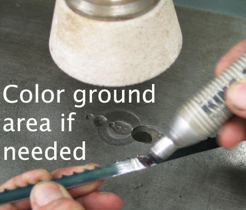

Not shown is what to do if there's ticking as the blade runs through the guides from a high spot. Color the blade with a felt tipped marker, roll the blade through a few revolutions, observe where the color has worn away and get out the dremel and grind down those spots.

Components |

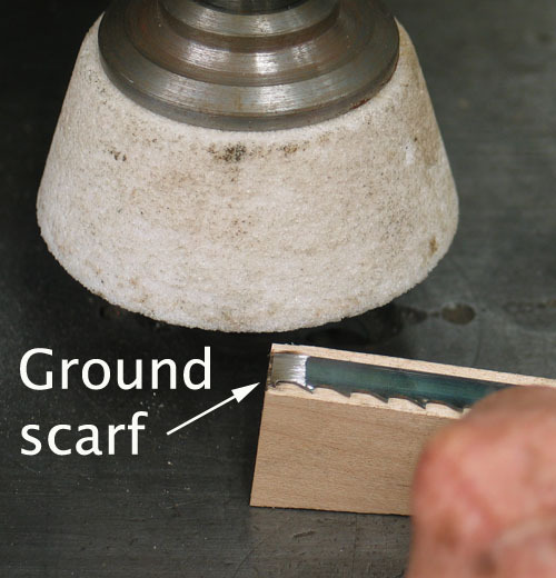

Grinding Block |
Grind Scarf |
Ground Scarf |
Ground Scarf Joints |
Holder |

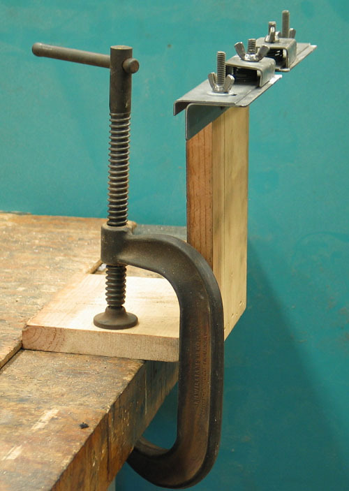

Clamp to bench |
Set jig for blad size |
Center the ground area in the slot |

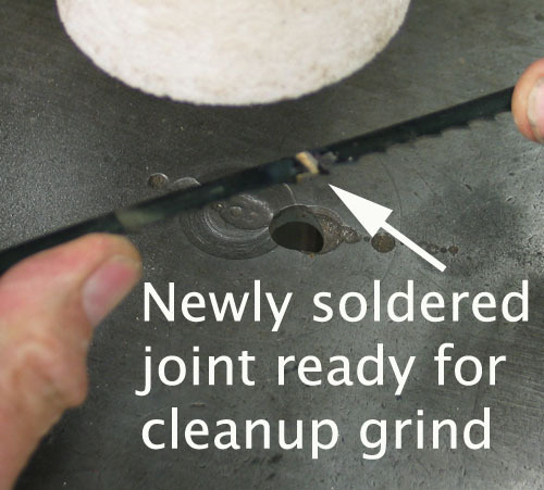

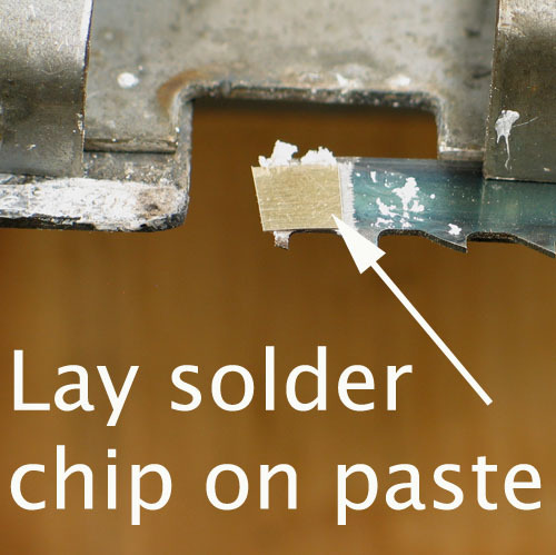

Apply Flux |

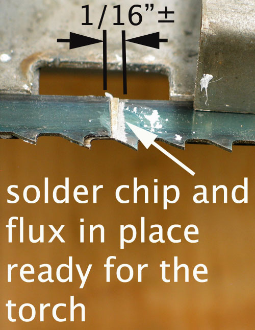

Apply Solder |

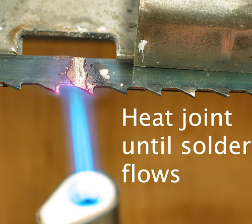

Ready for the torch |
Heat Joint |
Cool joint |

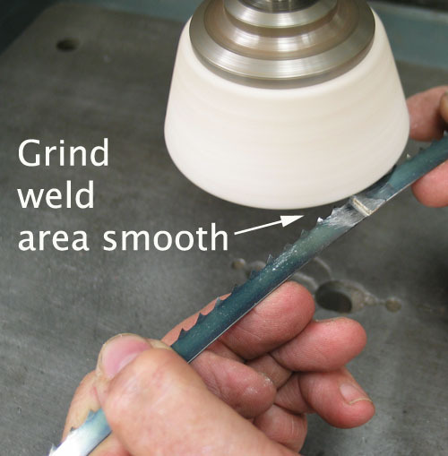

Get ready to grind |
Grind |
Color ground area |
