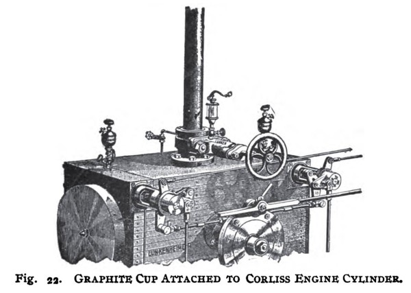

 Graphite Lubricator Cup Attached to Corliss Engine Cylinder
      Fig. 22 shows a way of attaching these cups to Corliss engines. They may also be attached to the steam pipe, but always below the throttle valve, as the graphite may interfere with the tight closing of the valve.
      When using graphite, an oil lubricator should also be used, but the quantity of oil can be reduced considerably.

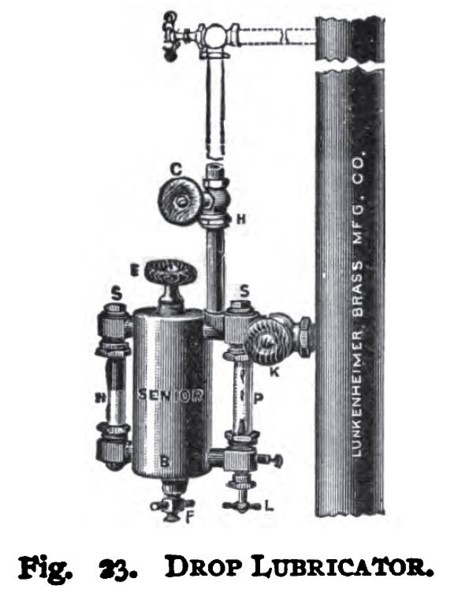

 Drop Lubricator
Drop Lubricator
Note.—Description of Fig. 23. B—Oil reservoir. C—Upper valve. E—Filling plug. F—Drain, valve. H—Union to connect condenser pipe and valve. K—Discharge valve. L—Valve for regulating flow of oil. N—Indicator glass. P— Sight-feed glass. Valve to drain or blow out sight-feed glass P.

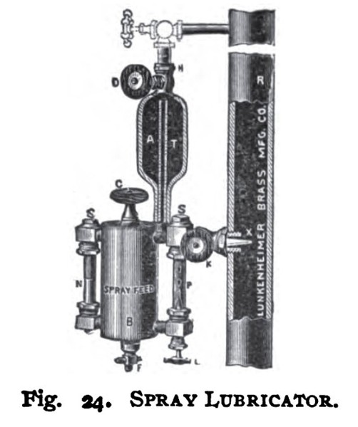

 Spray Lubricator
Spray Lubricator
Note.—Description of Fig. 24. A—Condensing chamber. B—Oil reservoir. C—Filling plug. D— Upper steam valve. F—Drain valve. K—Lower steam valve. L— Valve fo regulating flow of oil N—Indicator glass. P—Sight-feed glass. R—Steam pipe. SS—Plugs for cleansing and replacing glass. T— Circulating tube. X—Spray nozzle.

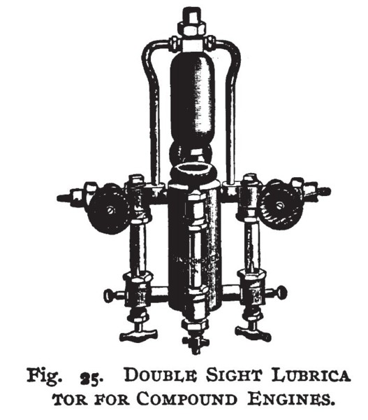

 Double Sight Lubricator for Compound Engines

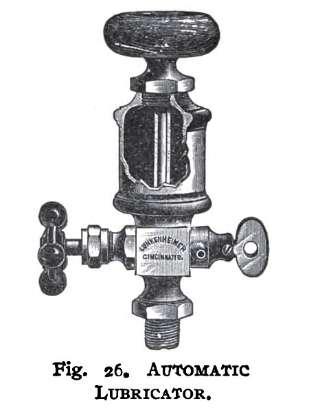

 Automatic Lubricator

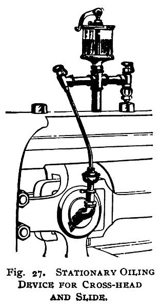

 Stationary Oiling Device for Cross-Head and Slide
      Every engine should be fitted with stationary oilers for crank-pin, wrist-pin and all other places where the bearing is a movable one. This will enable the engine to be run for many consecutive hours, if occasion should demand it. To be obliged to shut down to oil any of these places, is to show that whoever is in charge of the machine has failed to keep up with the times. See Fig. 27.
      In selecting a lubricator for a steam engine it is well to get one that is so constructed that when it must be filled, the cylinder oil will go directly into the cup, without having to go through a long crooked passage, for many good oils are thick and it is not always convenient to warm an oil before using it.
