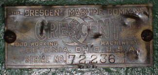

Sometime around 1940 or so (an exact time is not currently known), Crescent once again began to use a serial number tag on their machines rather than just stamping the number directly on the machine. These tags were used between when they started using tags again and when Crescent was bought out by Rockwell in 1945. During this period of time, Crescent used several style badges with known examples show below:

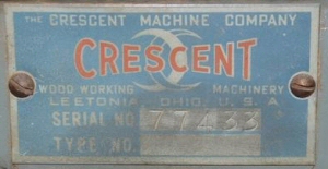

Another example of the early 1940's tag.

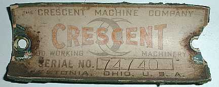

Also during this period (probably during WWII), Crescent used a tag made out of thick paste board - probably due to the shortage and rationing of metals during the war. Exact range of dates this tag was used is unknown but probably between 1942 and 1944. Below is a rare example of this tag as many have not survived due to them being made out of paper:

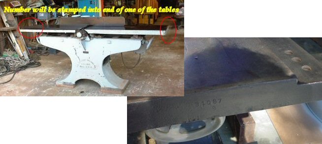

3.2.1 - Jointers
On jointers, the serial number is typically stamped onto the end of either the in-feed or out-feed table.

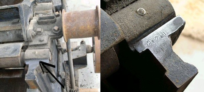

Serial numbers are often found on the front side of the upper arm of the saw stamped onto upper wheel adjustment device.

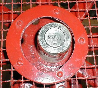

Serial numbers have also been found stamped onto the wheel and shaft of the upper band saw wheel as above.
