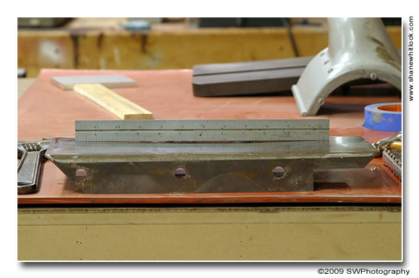

Rockwell Belt Sander Restoration Pics (updated all finished). You can see the platen is stamped steel instead of cast iron and it's in bad shape with more than a 1/8" bow in the center.
Mine also had the typical worn groove .. Right even with the top of the table.

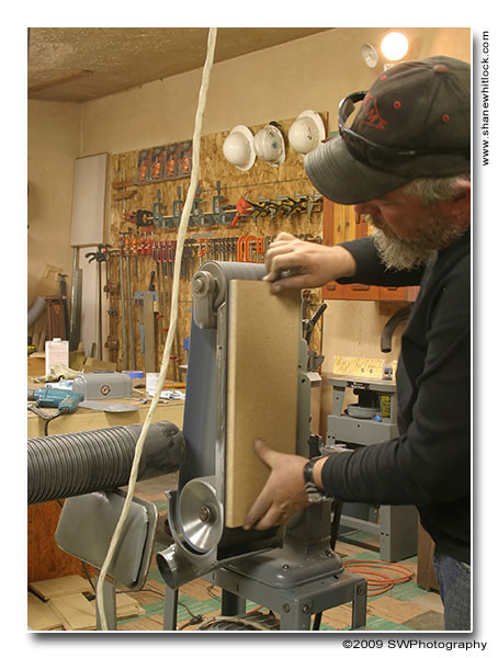

So to flatten it out I took some J.B. weld and mixed up enough to cover the surface.
After it set up over night I mounted the platen back on the sander. I then took some duct tape and wrapped the drums to protect them during the next step.
Next I took a new belt and turned it inside out and put it on the sander. I found a flat piece of OSB, turned on the sander and pressed the OSB firmly against the belt which sanded the J.B. weld down until the face of the platen was nice and flat. It took a while to flatten it out but it worked great. It helped to have my wife turn the tracking screw in and out so the belt moved side to side across the platen while sanding.
What it looks like now, nice and flat.
