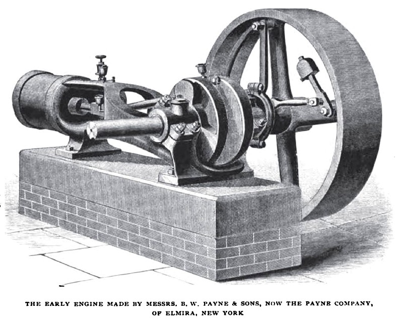

Payne Engine
Payne Engine
Some years before the Centennial, Messrs. B. W. Payne & Sons, of Elmira, New York, were, I heard, building shaft-governed engines, as were also Hall & Whitmore, of Havana, N. Y., but not particularly high speed, as I remember them.

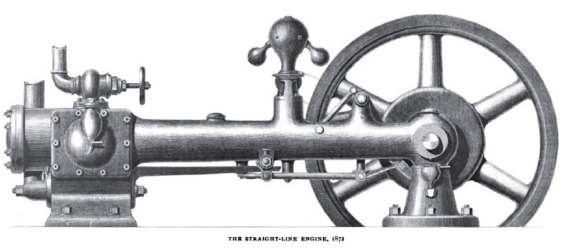

1872 Straight Line Engine

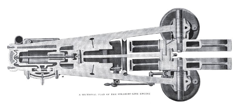

1872 Straight Line Engine (sectional view)
      The first Straight Line engine was built in 1872, purely to try a lot of experiments. I was well aware of the fact that, in general, it is not good practice to try two experiments at one time; but this was a different thing. To tell whether a long piston was better than a short one did not interfere with trying to find out whether a solid box was the thing for an engine main bearing, and these were the sort of experiments that were coupled together.
      It is doubtful if ever more departures were made in any standard machine than were in that conglomeration of mechanism,— casting the frame with the cylinder; making the frames straight and resting the whole on three points, with one unfastened; casting the jacket on the cylinder, with solid cast-iron boxes and ring oilers; putting the fly-wheels on the throws of the centre crank and building the whole up, which was then new, and thus putting the fly-wheels between the frames; using a long piston, one equal to the diameter of cylinder, secured to the rod in a new way (fastening the end in the cross-head by a half nut); a cross-head so long and guides so short that the two were of the same length; a cross-head pin tight in the connecting-rod and with two bearings in the cross-head; connecting-rod of steel casting, half of the box cast on, oiled through the crank-pin and a different method of oiling the guides. A single valve of the Porter-Allen type performed all the functions of a slide or piston valve. All the pivots, except the crank taper joints, had take-ups endwise. There was a novel governor of the fly-ball pattern, in which the ball traveled in an elliptical curve, which closely conformed to the parabola which had been determined to be the true form.
      In the old days there was about as much high science spread over the flyball governor as there has been in recent years over the shaft governor, and it came to an end about 1880 on the Cosine governor, about which there was a great ado. This Cosine governor was nothing more than the governor on the first Straight Line engine, scientifically developed rather than being made by hand. The governor controlled a sliding block in a link and varied the cut-off. The engine ran, off and on, for a number of years, and in a dozen different places as a helper in emergencies, ending up as the central figure in the Straight Line Engine Works.
      The experiment proved a good many things; about as many things that would not work as would. The long piston was a miss and a go. When these pistons did not get to cutting, they went very well; but they were more likely to cut than the short ones, or at least that seemed to be the conclusion.
      The rods through round holes proved successful when we found out how to make the holes. The taper cross-head pin would not do, but the long cross-head and short guides were right. They were made straight, and never wore out of straight,—in fact, never wore much anyway, and this, with the many other experiments I have tried, has established the fact that things which do not tend to wear out of truth do not wear rapidly. The oiling of the cross-head was a failure; that of the crank was a success. The solid boxes were right in one respect and wrong in another, and led to a compromise that was better. The frame and wheels within the frame were right and the governor was all wrong. The valve, as then made, was wrong, but made so successful later as to be what it is known today.

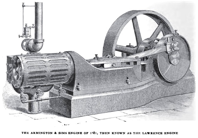

1881 Armington & Sims Engine
      B. W. Payne & Sons exhibited their first engine in the showroom of the American Electrical Company in New York in 1879, with the Tabor governor; Armington & Sims their first engine at the Paris Electrical Exhibition in 1881 direct connected to an Edison Jumbo dynamo, using the same governor up to the present time, I believe.

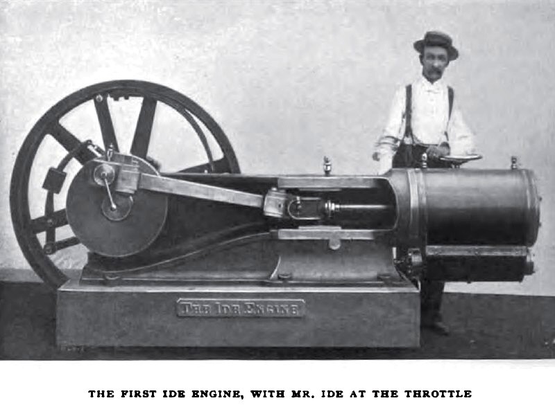

The First Ide Engine
Ide Engine (sectional view)
      The first Ide engine was built in the latter part of 1882 and one exhibited at the Railway Exhibition in Chicago in May, 1883. This engine had a single ball governor, but when I advised Mr. Ide that I had a patent that covered this form he at once acknowledged the claim and abandoned that form for a time: but later, after using the two-ball governor, he found it worked just as well with one as two, and so simply left one of the balls off. The question whether he had or had not the right to do that was very nice, and might have been a rich one for the lawyers.

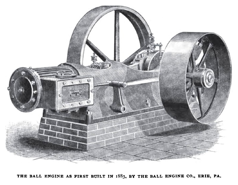

1883 Ball Engine
1883 Ball Engine
      The Ball engine was brought out in 1883, and the first one shown at the Mechanics' Institute Fair in Boston in the fall of 1883. The Ball governor was not only a shaft governor, but was also fitted with a band-wheel loose on the shaft, which acted to turn on more steam as the load increased. This was abandoned later for another form, and still later for another.
      The governor which weighs the load and the inertia governor deal with a variation on steam pressure precisely as others, and as all meet all reasonable demands, then the most simple, reliable, durable and easiest of adjustment is to be preferred.
