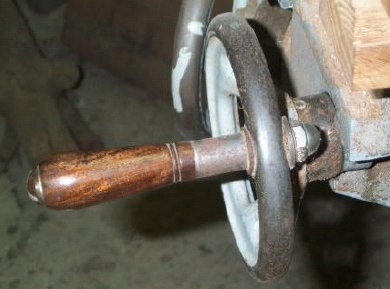

A handwheel or speed crank that is missing its handle can mark the beginning of a bad day. These parts are expensive and sometimes do not always exactly match other handwheels that may also be on your machine. The Burke Mill I purchased had this type problem. The first step here is to find a bolt that either threads into the handwheel or passes through the hole left by the missing spinning handle. Select a bolt long enough to give you three to four inches on the operator-side of the wheel and enough on the backside of the wheel to allow for an acorn nut to lock the bolt/shaft into position. If you need to secure the bolt with an additional nut or threaded sleeve on both sides of the handwheel, allow accordingly. The bolt should not spin and should be able to be firmly attached to the wheel. Now select a chunk of rosewood or cocobolo, bore a hole lengthwise through the blank- sized to allow the bolt to easily pass through it. Chuck this on a mandrel on your wood lathe and turn yourself one of the finest-quality spinning handles you’ll ever see. This truly classes up a machine in a woodworker’s shop.
