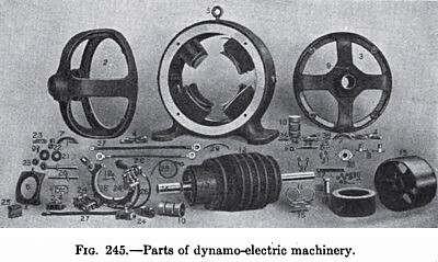

Principal Parts of Motors
      The principal parts of all dynamo electric machinery, whether they be generators of electricity or motors driven by electric current, are:
1. A magnetic field, commonly called a field, whose function it is to furnish magnetic lines. In the earlier machines this consisted of a two-pole magnet but the modern generators and motors are provided with four or more poles. The reason for this is that a more compact machine can be produced. A generator whose field consists of a two-pole magnet is called a bipolar generator, while one with a magnet consisting of four or more poles is called a multi-polar generator.
2. An armature which is made up of insulated windings of copper wire on an iron core. The function of the armature is to cut the magnetic lines of force furnished by the field. In all direct-current machines the field is the stationary part while the armature revolves. In alternating-current machines, the field is the revolving part in all but the very small machines.
3. A device which collects or delivers current to the armature, depending on whether the machine is a generator or a motor. In the case of alternating-current generators and motors this is accomplished by brushes pressing on collector rings, if the armature is the revolving element. In larger alternating-current
machines where the armature is the stationary part, the current is taken away from or delivered to the windings by leads entering the frame of the dynamo or motor. When dealing with direct current machines, current is delivered to or taken away from the armature by brushes pressing on a commutator whose function, as explained in the earlier part of this chapter, is also to change the alternating current into direct current.
4. A shaft passing through the revolving part, which is connected to the engine furnishing power in the case of the generator and to the machine to be driven in the case of the electric motor.
5. A frame, usually made of cast iron, whose function it is to support the bearings in which the shaft of the generator or motor revolves.
Parts of Dynamo-Electric Machinery |
      The various part of a D. C. Motor are illustrated in Fig 245.

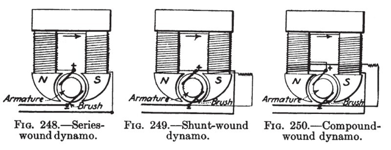

Series, Shunt & Compound Motors |
      Direct-current motors are divided into three classes depending on the type of field winding as series-wound, shunt-wound, and compound-wound. For simplicity these three types are represented as bipolar machines in Figs. 248, 249, and 250.
Series-wound Motors
      The series-wound motor has a winding similar to that of the series-wound generator. In fact, it is difficult to tell the difference between any direct-current motor and generator, the electrical features being the same. A series-wound generator when operated as a motor will run in reverse direction. The series-wound motor is used for work where hand control can be used as in the operation of hoists, cranes, and for the propulsion of electric cars. A series-wound motor can be started at full-load and should never be used where there is a possibility for the load to be removed suddenly. A series-wound motor will "run away"; that is, its speed will increase to such an extent that it may be destroyed by centrifugal force, if the load is removed. For this reason it is not safe to use belt drives with series-wound motors. A series motor is illustrated in Fig. 249.
Shunt-wound Generators
      The principle of a shunt-wound generator is illustrated in Fig. 249. The field winding consists of a great number of turns of very fine wire. Both ends of the field winding are connected to the brushes of the generator.
      Since the field winding is very small in comparison with the line wire, only a small part of the current flows around the field coils. This type of generator is used for charging storage batteries. A shunt-wound generator will supply constant voltage provided the load does not vary much.
Shunt-wound Motors
      The shunt-wound motor has the same type of winding as the shunt-wound generator. Shunt-wound motors are used for all kinds of work where fairly constant speed is desired. A well-designed shunt-wound motor will not vary much in speed with a variable load. In starting a shunt-wound motor it is necessary to put considerable resistance in series with the field of the motor. This is due to the fact that the resistance of the armature of a shunt-wound motor is very low. If a voltage of from 110 to 220 volts is allowed to pass through an armature of low resistance, an enormous current would flow through the armature in starting, which would result in injury to the armature coils, and also to the commutator by excessive sparking. By putting a resistance in series with the armature the current which is allowed to pass through it is decreased. Then, as the motor begins to speed up, the armature turning between poles of a magnet, produces a generator action which sends an electrical pressure in opposition to that which is sent in from the mains. This tends to reduce the current passing through the armature to a safe limit. In connection with this, it must be remembered, that weakening the field of a shunt-wound motor, reduces the above-mentioned generator action, and speeds up the motor. A break in the field connection of a shunt-wound motor, while it is in operation, may result in considerable damage by over-speeding.
Compound-wound Motors
      The compound-wound motor has a series and shunt winding like the compound-wound generator. It is used mainly for the driving of machines where very close speed regulation is essential, such as printing presses, machine tools, and looms.

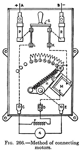

Method of Connecting Motors
Method of Connecting Motors |
      The method of connecting a shunt motor and its starting box to the circuit is illustrated in Fig. 266.
A and
B are the two leads which bring the current from the mains (connected to a generator) through the fuses
P, R and to the switch
S. One terminal of the switch
L is connected to the field
F and to the armature
G of the motor. The other terminal
K leads to the starting box. The handle
H of the starting box is connected with the terminal
E, which is attached to the armature of the motor. The other terminal
D of the starting box is connected with the field of the motor
F.
      When the motor is to be started, the switch
S is closed and the handle
H is on the contact point 1. The handle
H is then moved slowly to the right. When the handle
H is on the last contact point, it is held in position by the magnet
M. To stop the motor, the switch
S is opened. The magnet
M, losing its magnetism, allows a spring to bring back the arm
H to the starting point.

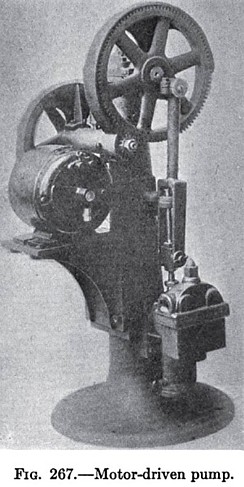

Motor Driven Pump |

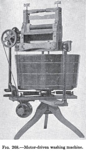

| Motor Driven Washing Machine |

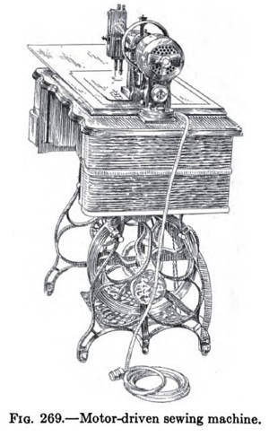

| Motor Driven Sewing Machine |
      Some of the uses of the electric motor in the home are illustrated in Figs. 267 to 269. The house pump driven by a motor of 1/6 hp. is shown in Fig. 267. Another electric motor of 1/10 hp. drives a washing machine illustrated in Fig. 268. Still a smaller motor is shown connected to a sewing machine in Fig. 269. Other uses to which the electric motor can be put in the farm household may be mentioned: the driving of fans during hot weather, of vacuum cleaners, of ice-cream freezers, of cream separators, of churns, of milking machines and of grindstones. An electric motor can also be used for the shelling and grinding of feed and for the many operations in the farm shop.

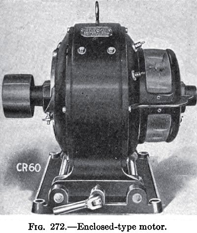

Enclosed Type Motor |
      If a motor has to be located in a dusty place, or in connection
with farming operations where particles of feed or trash may lodge on the motor, an enclosed type like the one shown in Fig. 272 should be selected.
