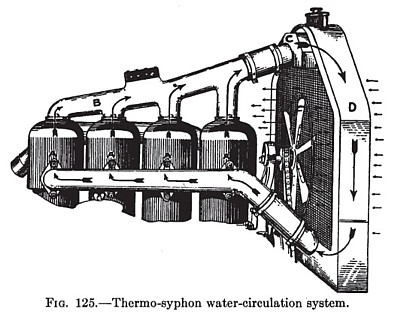

Thermo-Syphon Water-Circulation System
      A forced system of water circulation is usually employed with a rotary, a centrifugal, or a plunger pump. In the rotary pump the water is circulated by revolving gears and in the centrifugal pump by an impeller or paddle wheel. The rotary or centrifugal pumps are more generally used, as they are more simple. The thermo-syphon system of water circulation (Fig. 125) is used in some makes of traction engines.

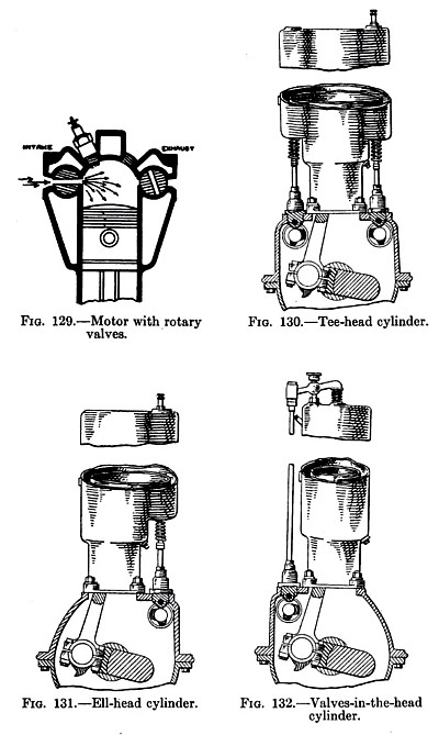

Automobile Type Valves
      The valves are arranged, as in automobiles (Figs. 130, 131, 132), in three distinct ways: namely, the tee-head, the ell-head and the valve-in-the-head construction. With the tee-head or the ell-head construction the valve seats are in a pocket cast on the side of the cylinder proper, which forms a very inefficient combustion space. The valve-in-the-head motor has a very compact combustion chamber.

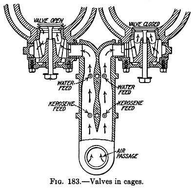

Valves in Cages
Valves in Cages
      In the valve-in-the-head type of motor, the cylinder head carrying the valves is a separate casting (Fig. 182) or has the valves mounted in removable cages (Fig. 183).
      Many makes of traction-engine cylinders are built with removable heads (Fig. 182). When the cylinder head is a separate casting, it can be removed easily for the purpose of cleaning, and the valves, with this form of construction, can be more thoroughly water-jacketed than when mounted in cages.
      When the valves are placed in cages (Fig. 183), the cage contains a seat for the valve and a guide for the valve stem.
      The exhaust valve seat is usually water-jacketed and in some designs the inlet valve seat is also water-jacketed in order to keep down the temperature of the incoming mixture.

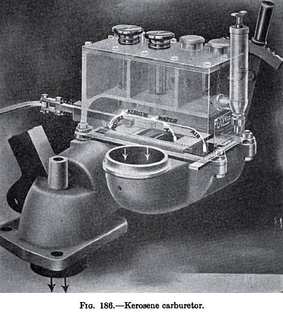

Kerosene Carburetor
Kerosene Carburetor
      Another form of kerosene carburetor, called the Secor-Higgins, is illustrated in Fig. 186. The three compartments from right to left are for gasoline, water and kerosene. The lower section is the mixing chamber. Gasoline is forced into the mixing chamber by means of a hand pump. Plunger pumps force water and kerosene into the compartments. The air enters through air intake ports. The amount of air entering the mixing chamber is controlled by the governor. The throttle opening which admits the mixture to the cylinder is also under the control of the governor.
      With kerosene fuel, water is generally mixed with the air and fuel to prevent preignition. Very little water should be used at light loads, and the quantity of water injected at higher loads should be sufficient only to produce proper operating conditions. With heavier liquid fuels, the capacity of an engine of the same bore, stroke and speed is increased by water injection. Water injection also reduces the amount of carbon deposit, but produces a slower burning mixture with the consequent poorer fuel economy.

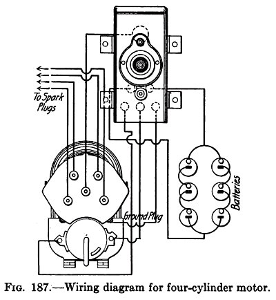

Wiring Diagram for Four Cylinder Motor
      A wiring diagram for a four-cylinder traction engine is illustrated in Fig. 187.

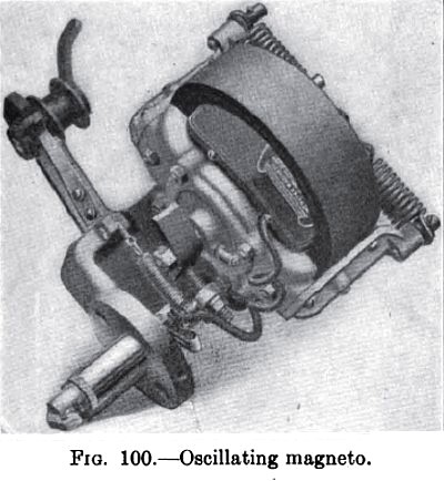

Oscillating Magneto
Oscillating Magneto
      The make-and-break system of ignition is used to a limited extent for small traction engines in connection with a slow-speed single-cylinder motor. With the make-and-break system an oscillating magneto (Fig. 100) is often employed.

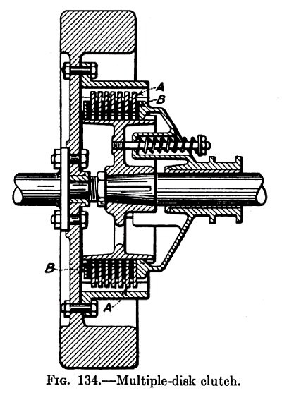

Multiple Disk Clutch

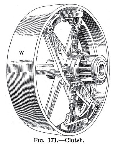

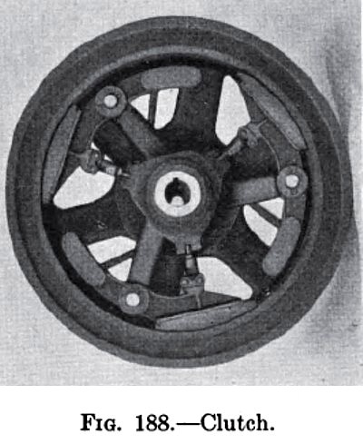

Traction Engine Clutch

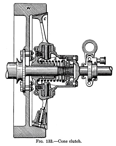

      The clutch of the gas traction engine has the same function as that of the automobile and connects or disconnects the motor from the propelling gear. The types of clutches used for gas traction engines are similar in principle to those illustrated in Figs. 133, 134 and 171. The expanding-cone, expanding-shoe, multiple-disc, floating-plate and clamp-plate types are employed. Usually one part of the clutch is part of the flywheel. A traction-engine clutch is illustrated in Fig. 188.

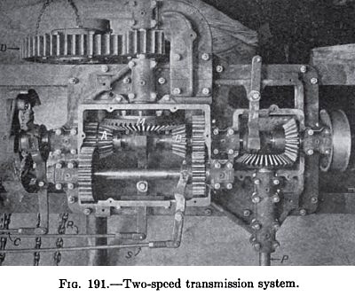

Two Speed Transmission System
      A two-speed transmission system is shown in Fig. 191. The reversing mechanism consists of two bevel pinions (A, B) which are driven from the motor shaft. The bevel gears A and B drive the differential driving gear D through the large bevel gear M. In the neutral position these bevel gears A and B revolve freely. The lever R is used for connecting either bevel gear A or B with the driving shaft. The lever S controls the speed freely. The lever R is used for connecting either bevel gear A or B with the driving shaft. The lever S controls the speed changing gears and the lever C is for the clutch. The shaft P is for the belt pulley.

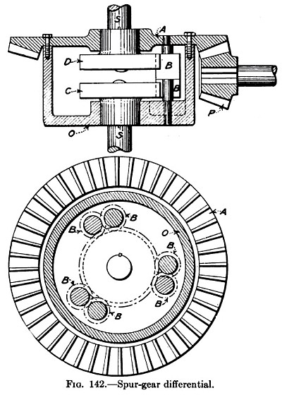

Spur-Gear Differential

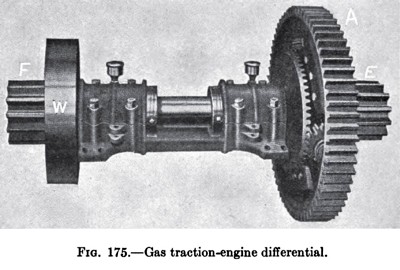

      Differentials for gas traction engines were illustrated and described in connection with Figs. 173, 174, and 175. Spur-gear differentials similar to that of 142 are also employed in some gas traction engines. Some of the light traction engines dispense entirely with the differential and use only one traction wheel.

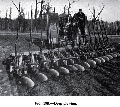

      With a traction engine the processes of plowing, seeding, and harrowing can be carried on in one operation (Fig. 197). Deeper and more uniform plowing (Fig. 198) can be carried on.

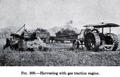

      Harvesting operations with steam and gas traction engines are illustrated in Figs. 199 and 200.

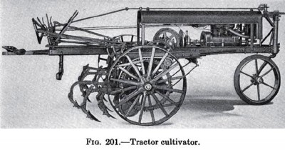

      Power cultivators are being placed on the market which are suitable for cultivating corn and other rowed crops. One form of tractor cultivator is illustrated in Fig. 201. The motor of this machine is placed on the frame near the front and is a four cylinder vertical internal-combustion motor with the cylinders cast en-bloc similar to automobiles. One of the special features of this traction engine is that the two drive wheels are operated separately by means of friction-drive transmission. The mechanism is so arranged that one wheel can be held stationary while the other travels forward or backward. To facilitate turning around at the end of a row of corn, in order to go up in the next row, the operator throws out the gear connection in the steering apparatus and the front wheel acts as a caster. Then, by operating the rear wheels, the machine can be made to turn completely around. The cultivator gangs are operated by the driver's feet.

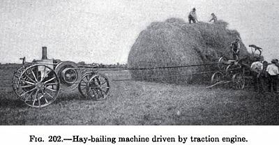

Hay Bailing Machine Driven by Traction Engine
      The traction engine is suitable for heavy-belt work, such as hay baling (Fig. 202), corn shelling, pumping water for irrigation and for other purposes, grinding feed, ensilage cutting, sawing wood, threshing, husking, hulling, shredding, filling silos, crushing rock, and elevating corn and grain. Traction engines can be used for hauling grain and other farm products to the shipping point or to the market; for hauling fertilizer and other material to the farm; also for moving houses, barns and other structures.

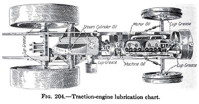

      Bearings may be oiled by means of grease cups (Figs. 53, 54), or by sight-feed lubricators (Fig. 56). Gears are lubricated with grease or with some other heavy lubricant. Transmission grease is generally used for the transmission. In some cases heavy steam-cylinder oil is employed for the same purpose. Cylinders for steam traction engines are lubricated with heavy steam cylinder oil by a mechanically driven oil pump or by an automatic sight-feed steam lubricator (Fig. 57). A medium gas-engine cylinder oil should be used for lubricating gas traction-engine. A combination of splash and forced-feed oiling system is often used for traction-engine lubrication.
Traction Engine Lubrication Chart
      The instructions furnished by the manufacturer regarding the kind of oil to be used and the lubrication of the various parts should be carefully followed. A lubrication chart for one make of traction engine is illustrated in Fig. 204. The bearings of magnetos require frequent attention. A high-grade sewing machine oil should be used for this purpose.

      To put the traction engine in motion the clutch is thrown in gradually after the lever controlling the change gears has been shifted to the position required. In stopping a traction engine, the carburetor throttle is closed, the switch is opened, the clutch is disengaged and the change-speed lever is placed in neutral. Failure to place the lever controlling the change gears in the neutral position will start the tractor if the clutch is disengaged. The operator never should try to reverse a traction engine without first bringing the machine to a stop. The operation of the traction engine is controlled by the carburetor throttle lever.

      A traction engine should be kept at all times in adjustment and in perfect working condition. This cannot be accomplished unless the engine is housed properly. A traction engine represents a large investment, the depreciation of which can be greatly reduced if the housing question is carefully considered. A frame or a concrete structure should be provided which not only will house the traction engine but will leave sufficient space for a farm workshop where ordinary repairs can be made.
      The tractor operator should do his repairing systematically. At the completion of a hard season's work the machine should be thoroughly overhauled. All old grease and oil should be removed from cylinders, bearings and transmission case. All parts should be cleaned with kerosene. Bearings should be examined, and adjusted by means of liners. In ordering repairs for engines, give description or sketch of the part as well as the number and letters found on the parts wanted. The number and size of the engine also should be stated.
      The clutch should be examined frequently for worn parts.

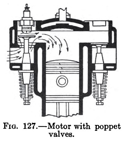

      Valves for gas traction engines should seat properly and should be reground if indications show wear. To grind the valve into its seat the valve spring is removed and the valve is taken out. Flour emery dust and oil, or fine Carborundum valve-grinding paste and oil is placed on the valve seat. By using a brace holding a screw-driver bit in the slot on the top of the valve, the valve may be revolved back and forth on the seat with very little effort. It is best to place a light spring on the valve stem so that the valve is held up and off from its seat.
      The time of opening and of closing of the valves of gas traction engines depends upon the speed of the engine. The valves of a high-speed engine should open sooner and remain open longer than those of a slow-speed motor. Ordinarily, the exhaust valve should open 30° to 50° before the beginning of the exhaust stroke and should remain open 4° to 10° after the completion of that stroke. The inlet valve should open 5° to 12° after the beginning of the suction stroke and should close 18° to 25° after the completion of the suction stroke.
