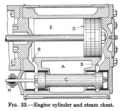

Engine Cylinder & Steam Chest

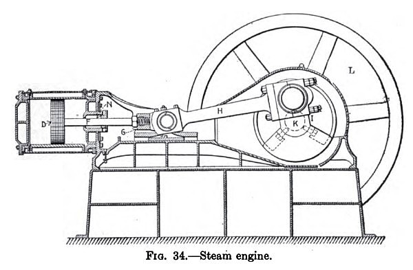

Horizontal Steam Engine
      The various parts of a steam engine are illustrated in Figs. 33 and 34.
      Steam from the boiler at high pressure enters the steam chest A, Fig. 33, and is admitted through the ports BB alternately to either end of the cylinder by the valve C. The same valve also releases and exhausts the steam used in pushing the piston D. E is the cylinder in which the steam is expanded.
      The motion of the piston D, Fig. 34, is transmitted through the piston rod F to the cross-head G, and through the connecting rod H to the crank I, which is keyed to the shaft K.
      The shaft is connected directly, or by means of intermediate connectors such as belts or chains, to the machines to be driven. The shaft carries the flywheel L, the function of which is to make the rate of rotation as uniform as possible and to carry the engine over dead-center. The dead-center occurs when the crank and connecting rod are in a straight line at either end of the stroke, at which time the steam acting on the piston will not turn the crank.

      Stuffing boxes which prevent the escape of steam around the rods are illustrated at M and N in Figs. 33 and 34.
      The size of a steam engine is given in terms of the cylinder diameter and length of stroke of the engine. Thus if an engine is called an 8-in. by 10-in. engine, this means that the diameter of its cylinder is 8 in. and its stroke or piston travel is 10 in.

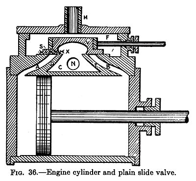

Action of the Plain Slide Valve
Engine Cylinder & Plain Slide Valve
      The action of the plain slide valve will now be taken up in detail, as a thorough knowledge of this type of valve will enable one to understand all other forms. Referring to Fig. 36, which shows a section of a cylinder with the slide valve in mid-position, A and B are the steam ports, which lead to the two ends of the cylinder; C is the exhaust space. The steam ports are separated from the exhaust space by the two bridges D and E. F is the steam chest. V is a plain slide valve, commonly called a D slide valve. The amount S that the valve V overlaps the outside edge of the port, when in the middle of its stroke, is called the steam lap. Similarly the amount by which the valve overlaps the inside edge of the port when it is in mid-position is called the exhaust lap. M and N are the steam and exhaust pipes respectively.

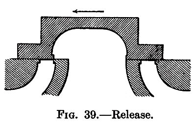

      The four valve events are: admission, cutoff, release and compression. Admission is that point at which the valve is beginning to uncover the port, as shown in Fig. 37. Cutoff occurs (Fig. 38) when the valve covers the port, preventing further admission of steam.
Release
Release

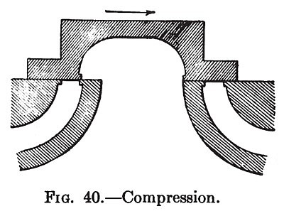

Compression
Compression
      This is followed by the expansion of the steam until the cylinder is communicated with the exhaust opening, at which time release, as shown by Fig. 39, occurs. Compression occurs when communication between the cylinder and exhaust opening is interrupted (Fig. 40) and the steam remaining in the cylinder is slightly compressed by the piston. The valve is in the same position at cutoff as it is at admission, only it is traveling in the opposite direction. Similarly the positions of the valve are the same at release and compression.
      By lead is meant the amount that the port is uncovered when the engine is on either dead-center. The object of lead is to supply full pressure steam to the piston as soon as it passes the dead-center.

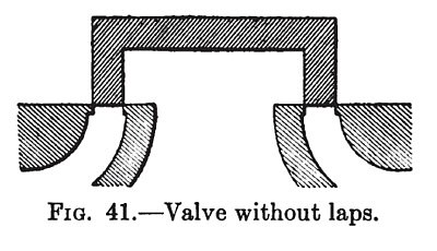

Valve Without Laps
Valve Without Laps
      If a valve is constructed without laps, as shown in Fig. 41, steam would be admitted to the cylinder at one end or the other and exhausted at the opposite end, if the valve is moved slightly in either direction. This would mean that steam admission at one end would take place throughout the entire stroke of the piston and would be exhausted from the opposite end at the same time. It is evident that a valve without laps will have no cutoff and steam will not be used expansively. To use steam without expansion is very uneconomical and is resorted to only in direct-acting steam pumps. For best economy a steam engine should be provided with a valve which cuts off at about one-third of the stroke.

      This is remedied by the piston valve shown in Fig. 33, which is perfectly balanced, or by some form of balanced slide valves, illustrated in Fig. 42, which works between the valve seat and a balance plate with an accurate mechanical fit.

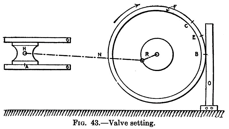

      The object of setting valves on an engine is to equalize as much as possible the work done on both ends of the piston. A valve may be set so that both ends have the same lead, or so that the point of cutoff is the same at both ends. Before a valve can be set, the dead-centers for both ends of the engine must be accurately determined. The method of setting an engine on dead-center can best be understood by referring to Fig. 43. H represents the engine crosshead which moves between the guides marked G, N is the connecting rod, R the crank, F the engine flywheel, and 0 a stationary object.
      To set the engine on dead-center, turn the engine in the direction in which it is supposed to run, as shown by the arrow, until the cross-head is near the end of its head-end travel, and make a small scratch mark on the cross-head and guide, as at A. At the same time mark the edge of the flywheel and the stationary object opposite each other, as at B. Turn the engine past dead-center, in the same direction as shown by the arrow, until the mark on the cross-head and that on the guide again coincide at A, and mark the flywheel in line with the same point on the stationary object, obtaining the mark C. The distance between the two marks on the flywheel is now bisected at E. If the mark E on the flywheel is now placed in line with the mark on the stationary object, the engine will be on the head-end dead-center. Similarly the crank-end dead-center can be found.
      The stationary object may be a wooden board, or a tram may be used with one end resting on the engine bed-plate and with the other end used for locating the marks B, C, and E on the flywheel.
      If a valve is to be set for equal lead on both ends, set the engine on the dead-center by the method given above, remove the steam-chest cover, and measure the lead at that end. Move the engine forward to the other dead-center and measure the lead again. If the lead on the two ends is not the same, correct half the error by changing the length of the valve stem, and the other half by moving the eccentric.
      To set an engine for equal cutoff, turn the engine until the valve cuts off at one end and mark the position of the cross-head on the guides. Then turn the engine until cutoff occurs on the opposite end and again mark this position of the cross-head on the guides. If the cutoff occurs earlier at one end than at the other, shorten the valve stem until the cutoff is equalized at both ends.

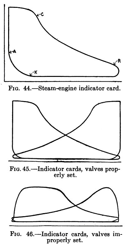

Steam-engine Indicator Cards
Steam Engine Indicator Cards
      In general the best method of setting valves is by means of a steam-engine indicator. This form of instrument shows directly the action of the steam inside the engine cylinder, recording the actual pressure at each interval of the stroke. An indicator card taken by means of an indicator is shown in Fig. 44. The events of stroke on the card are marked: admission A, cutoff C, release R, compression K. Fig. 45 shows indicator cards taken from two ends of a cylinder with a valve properly set, while Fig. 46 shows indicator cards taken from an engine where the valve is poorly set.

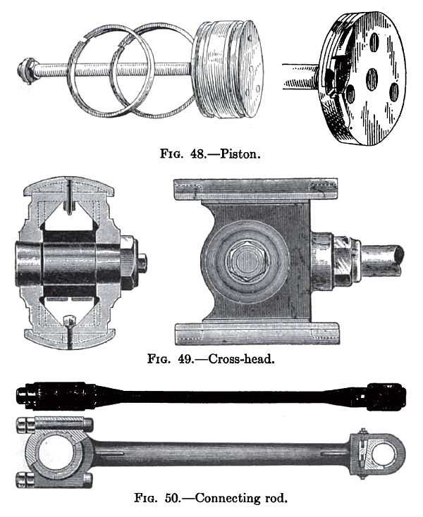

      The general construction of steam-engine cylinders can be seen from the previous illustrations. Steam engine cylinders are made of cast iron. As the cylinder wears it has to be re-bored so as to maintain true inside surfaces. The thickness of the cylinder walls not only should be strong enough to withstand safely the maximum steam pressure, but should allow for re-boring. All steam-engine cylinders should be pro vided with drip cocks at each end in order to drain the cylinder and steam chest when starting. A good piston should be steam-tight and at the same time should not produce too much friction when sliding inside the engine cylinder. The piston is usually constructed somewhat smaller than the inside diameter of the engine cylinder, and is made tight by the use of split cast-iron packing rings. In Fig. 48 is illustrated a piston with its packing rings.
Piston, Cross-Head & Connecting Rod
      The general construction of steam engine cross-heads is illustrated in Fig. 49. All cross-heads should be provided with shoes which can be adjusted for wear.
      Fig. 50 shows a connecting rod. It is connected at one end with the cross-head and at the other with the crankpin. A connecting rod should be so constructed that the wear on its bearings can be taken up. This is usually accomplished by wedges and set screws as illustrated.

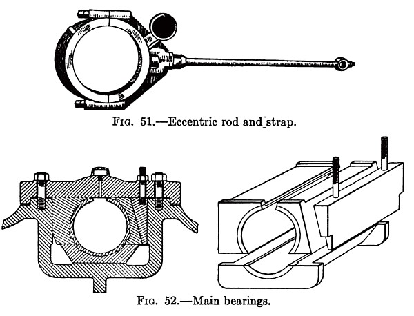

Eccentric Rod & Main Bearings
      Fig. 51 shows an eccentric rod and strap. The main bearings of steam engines are illustrated in Fig. 52. These bearings are usually made in three or four parts and can be adjusted for wear by means of wedges and set screws fastened with lock-nuts.

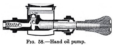

Hand Oil Pump
Hand Oil Pump
      Fig. 58 shows a hand oil pump which is sometimes used to admit oil into the cylinder of an engine when starting.

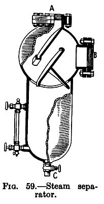

Steam Separators
      The function of a steam separator is to remove any water which may be contained in the steam before it enters the engine cylinder. A separator placed in the exhaust pipe of an engine will remove a large part of the oil, making the exhaust steam more suitable for heating, manufacturing purposes, or for use in steam boilers after condensation.
      The importance of having the steam entering the engine cylinder as dry as possible was explained in an earlier part of this chapter. A good steam separator, if of sufficient size, will insure fairly dry steam and should be used in connection with all stationary steam engines.
Steam Separator
Steam Separator
      Fig. 59 shows in section one form of steam separator. The wet steam enters at A, strikes the deflecting plates, its velocity is decreased and the entrained water, which is heavier than the steam, falls to the bottom and is removed at C by means of a trap. The dry steam passes out at B.

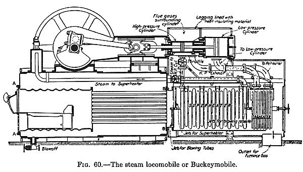

The Steam Locomobile or Buckeymobile
      The locomobile, as built in Europe, and the Buckeymobile of the United States, is a self-contained power plant, which consists of a compound steam engine mounted upon an internally fired boiler. An insulated sheet-metal smoke box incloses both engine cylinders, a superheater, all steam piping and valves, and a reheater which imparts heat to the steam as it passes from the high- to the low pressure cylinder. This arrangement utilizes the heat in the flue gases for superheating the steam before it enters the engine cylinder, for reheating the steam between the high- and the lowpressure cylinder, for reducing heat losses within the engine and for cutting down the radiation losses of the entire power plant.
      The steam from the engine exhausts through a feed-water heater into a condenser, where it is condensed (converted into water) by direct contact with cold water or by contact with tubes through which cold water circulates.
      Fig. 60 shows a longitudinal section of a Buckeymobile with the various parts named. This form of power plant has found a large field of application in Europe on account of its compactness and good fuel economy. The Buckeymobile, in small sizes, will no doubt in time be used to a considerable extent in rural communities in connection with flour mills, for irrigation pumping plants and for electric light plants in small towns. The principle of this type of power plant should also find successful application in connection with steam traction engines.

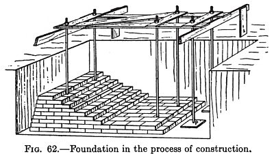

      Foundations for stationary steam engines are usually put in by the purchaser, the manufacturer furnishing complete drawings for that purpose. Drawings of a board template are also included. A template is a wooden frame which is used in locating the foundation bolts and for holding them in position while building the foundation. Before starting on the foundation a bed should be prepared for receiving it. The depth of bed depends on the soil. If the soil is rocky and firm, the foundation can be built without much difficulty. When the soil is very soft, piles may have to be driven. The ground for receiving the piles should be excavated to a depth of about 2 ft.
      The wooden template is then constructed from the drawings, holes being bored for the insertion of foundation bolts. Foundations may be built of masonry or of concrete. If of concrete the mixture should consist of 1 part of cement, 2 parts of sharp sand and 4 parts of crushed stone. The stone should be of size as will pass through a 2-in. ring. In starting on a concrete foundation, a wooden frame of the exact shape of the foundation is built.
Foundation under Construction
      This template is then placed in position in the manner shown by Fig. 62, and the bolts are put in, the heads of the bolts being at the bottom in recesses of cast-iron anchor plates marked P. Often the foundation bolts are threaded at both ends and the anchor plates are held in place by square nuts. A piece of pipe should be placed around each bolt, so as to allow the bolts to be moved slightly to pass through the holes in the engine bedplate, in case an error should occur in the placing of the bolts, or in the location of the bolt holes in the engine bedplate.
      With the frame, template and foundation bolts in place, the concrete can now be poured and tamped down. After the concrete has set, the template is removed and the foundation is made perfectly level. It is well to allow a concrete foundation to set several weeks before placing the full weight of the engine on it. When the foundation is ready, the engine is placed in position and leveled by means of wedges. The nuts on the bolts are now screwed down and the engine is grouted in place by means of neat cement, this serving to fill any crevices and to give the engine a perfect bearing on the foundation.
