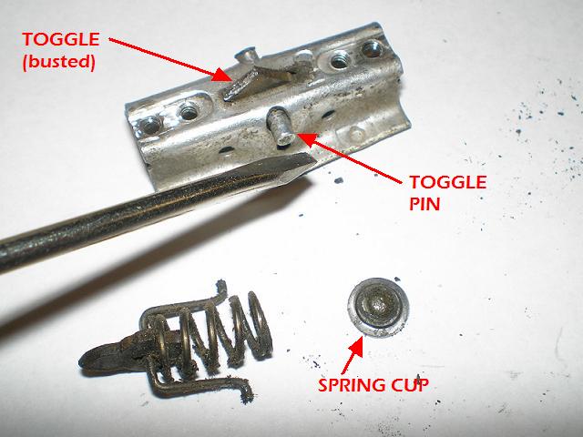

Next, remove the clip and spring from the metal switch top:
Use a small screwdriver to depress the clip, but be prepared to catch the spring and other small parts (also see below). They tend to jump when released.
A word about toggle pins. . .
PIN TYPE ONE:
On this switch the toggle pin is large on one end and narrow on the other. The thin end has a small pressed-on sleeve to hold the toggle in place. When the sleeve is off, the toggle fits snuggly on the narrow end of the pin. The skinny part of the pin is even skinnier in the center, so the toggle is free to move when the toggle is pressed onto the skinny end all the way over to the center of the pin. In the picture above, the pin end closest to the arrow point is the large end. The visible part of the other end is the sleeve; note that it has a flared end. Clear enough so far? No? See the drawing below.
Take a moment and peruse the first picture in this post and notice that the pen end is flared and dimpled. The sleeve appears to have been spun-pressed almost like a hollow rivet. Don’t simply grind this off to loosen the sleeve. You will need all the length you can get. I pressed the flare back down with pliers and worked the sleeve off with a screw driver and pliers by prying, tugging, twisting, pulling… (see below) Don’t worry about the sleeve. It won’t survive. We’ll replace this later with brass. SAVE THE PIN at all costs.

The second pin type is solid and has no sleeve. Instead, it simply has a swell pressed into the center of the pin. The toggle is pressed solidly onto this swell, which is unlike pin type one in which the toggle fits loosely on the pin. This fits much like a bearing on a knurled shaft. You’ll notice this difference if you see it.
