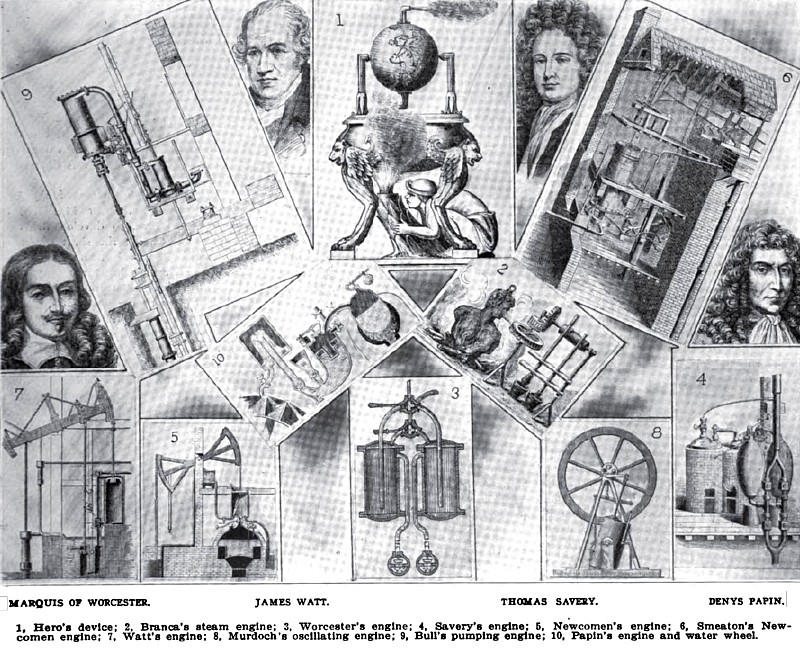

Hero and Branca
      Since the advent of the steam turbine, it has been repeatedly brought to our attention that the turbine form of engine was the first one to be proposed, and Hero’s device of 200 B. C. has been frequently mentioned and illustrated. His device was at most an interesting scientific toy, but some of the later developments were also along this line. The first one which was even suggested as a useful machine was that of Branca, who in 1629 proposed a horizontal jet wheel driven by steam, the illustration showing an application of this to grinding corn, but there is no evidence that this was put into use.
The Steam Syringe Period
      It remained for the Marquis of Worcester at about the same time to first apply the force of steam for actual work. This was done in the pumping of water at Raglan Castle by a device which is to all intents the same in operation as the modern pulsometer, except that it is not automatic. It is interesting to note that, up to this time, no engine using a cylinder and piston had been considered, and the first one proposed was a combustion engine invented by Huygens in 1680, to be used with gunpowder.
      Improvements on Worcester's device, which was of necessity a high-pressure machine, were made by Savery, who installed a number of plants for pumping water from mines in the Cornwall district. He proposed the use of this engine for driving mills, the method being to raise water with it and then use the water in a wheel, but this was never put into practice. The addition of the safety valve to the steam system by Papin was followed by the production of the first steam engine with a piston, but his method of applying this for power was the same as Savery's, viz., through a water wheel.

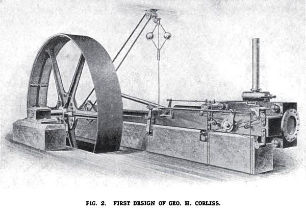

      The drop cutoff principle was developed about 1841 by Sickels, for use on marine engines; it was adopted for stationary engines by Thurston, Green Co., of Providence, R. I., and Corliss' invention consisted in the rotary valve and the attachment of the governor to the cutoff mechanism so as to determine the time of releasing the valves. This was accomplished in 1849 and from that time until the present the Corliss engine has been looked upon as the highest form of reciprocating engine construction.
      When Corliss entered the field, steam pressure stood at 70 pounds and piston speed at 400 feet a minute and an engine of 500 horsepower was tremendous. At the time of expiration of his patent in 1870, four hundred and fifty engines were in actual operation under Mr. Corliss' patent.

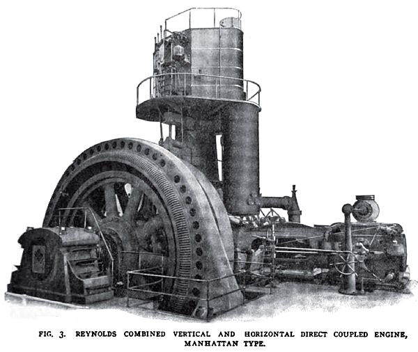

In the development of the Corliss design, Edwin Reynolds has been one of the most prominent engineers. Starting in the old Corliss works, Mr. Reynolds perfected a new form of hook releasing gear which has now become the standard with a great number of Corliss engine builders and he changed the form of frame from the girder type used by Corliss to the heavy duty type now common. To his genius is due also the combined horizontal-vertical form which is conceded to be the most compact construction of reciprocating engine where large power must be put into small space.
