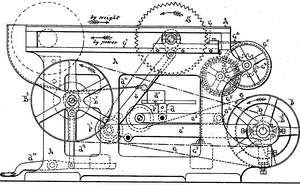

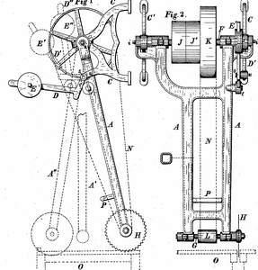

In 1869 Charles R. Tompkins patented a swing saw. Swing saws already existed then but this is the earliest swing-saw patent we have found. Tompkins manufactured his saw for many years, and his was just one of several such saws on the market. Levi Houston Co., American Saw Mill Machinery Co., Bentel, Margedant & Co., Connell & Dengler Machine Co., and Heston & Anderson are just a few of the other makers of swing saws. Swing saws are well suited for rough work but not to the precision work of a cabinetmaker or patternmaker.
Tompkins' swing saw
Tompkins' swing saw
Connell & Dengler's swing saw

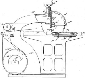

Mackintosh Hutchinson's radial arm saw
1915 ad
1915 ad
The patent drawing and advertisement above show Mackintosh Hutchinson's floor-mounted saw. Hutchinson's saw is not a modern design because it is powered by a belt (to a line shaft or motor), which complicates the mechanicals compared to a direct-drive saw. Hutchinson sold this saw both under the Mackintosh Hutchinson name when he lived in Toronto, and under the Hutchinson Manufacturing Co. name when he was based in Norristown, PA.
