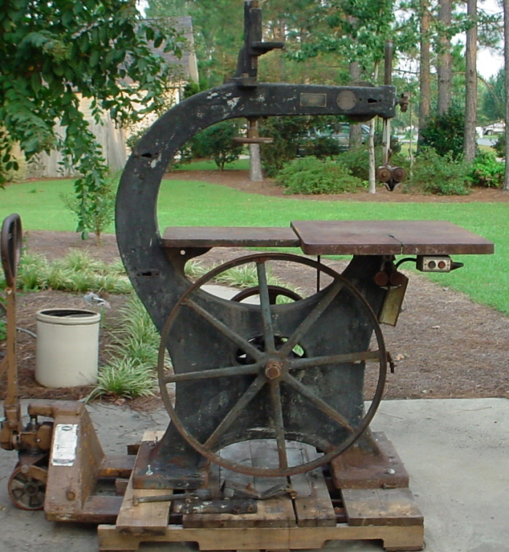

Unloading was actually pretty easy. The bed of entire trailer is designed to tilt at the axle when a lookdown is released at the front. I borrowed a pallet jack from my office and moved the saw back just enough to balance it over the axle and then released the trailer and slowly tilted the bed to the ground. I then jacked the pallet up with the pallet jack and rolled it off of the trailer nice and slowly.
Once unloaded, the first thing to do was start cleaning the saw up. I sprayed the entire machine down with some good de greaser and then pressure washed everything to remove most of the oil, dirt and grime that had accumulated on it over the past 100 or so years. Most of the old gray paint that had been brushed on at some point came off with ease under the power of the pressure washer. Here is a shot after cleaning her up a bit:

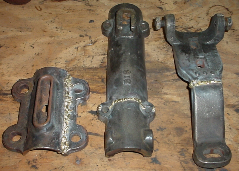

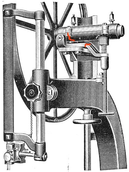

Next was to start removing all of the parts off of the band saw. When I bought the saw, I had been informed that there were a few broken parts. Two pieces on the top bearing had been broken at some point in time - probably when the machine was knocked over on it's side out in weeks outside the factory that it was found. This would be a problem as I began to restore the saw. Here are a couple of shots of the two broken parts:
And to show where they go on the machine, here is a drawing of the upper bearing assembly where the parts came from with the red lines showing approximately where the breaks were:
After some discussion on the OWWM forum, I decided that the best way to handle the broken parts was to braze them back together and then send them to Cattail foundry, a foundry in PA that is ran by Amish foundry men and have them cast new parts. More on this later.

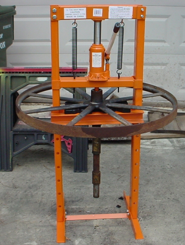

The job for today was getting the axle out of both the top and bottom wheels. I had a hydraulic press that I could use but the wheels were way to large to fit up on the table. Improvising, I took the top of the press apart and slipped the wheels on over the two uprights and then re-assembled the top of the press to do the job. While it added a little more work taking the press apart, it actually worked out just fine - just took a little while. Here is a pictures of me pressing the axle out of one of the wheels.

It has been a busy few days. Unfortunately, this has meant that the band saw restoration has not been on the list of things to do. I finally got a chance today to get the couple of broken parts brazed up. I made a trip to the local welding supply house and bought a handful of brazing rods - cost about $3.50. Then I made a trip to a local farmers shop that would let me borrow his torch for this job. Now, I first may tell you that I was a wee bit worried about doing this brazing job. The last time I brazed anything was back in my sophomore year of high school when I took a metals technology class. That was in 1982. I did a little reading to before hand to refresh my memory and just got in there and started brazing. It did not take long and it was all coming back to me. In the end, I got the three parts brazed back together and I thought that the brazing job was pretty good - epically since it has been 22 years since the last time! Picture below.
8 - Friday, October 8, 2004
Not much time today to do anything but I did want to get the parts ready to send out to the foundry for re-casting. Because my goal here was to stick the parts back together well enough to be used as patterns rather than holding up for use, I decided to grind the brazed joints down as close to the original shapes as possible. I used a pneumatic die grinder and a carbide rotary file and ground the beads down flush with the metal. On the case of the short bearing cap (the one of the left in the pictures), I wanted to make sure that the area where the weld is had a nice fillet so that it would be strong in the resulting casting. The grinding went pretty fast and the brass cut off much faster than the cast iron so it was easy to remove the brazed portion without removing much cast iron. I do plan to use some epoxy filler to fill in a few small voids that did not get brazed up well.
