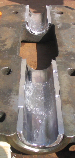

 The two bearings after the pour
1.7 - After the pour
After you finish your pour, the best thing to do is just walk away from it and leave it for a couple of hours. The parts need to cool down before you can do anything further. Do not try and pour water on the bearings to cool them off or you may cool things too quickly causing the bearing to shrink and not hold in place. Also, if you move the arbor while the metal is still too hot, you can actually deform the bearing resulting in a loose fit. After this pour, I went to town to do run some errands and eat lunch. I left things alone for about two hours before even trying to do anything. Just let it cool off all by itself real nice and slow!
When I returned, the first thing to do was to remove the arbor. Before I could do this, I first had remove some of the metal that had bridged over the top. To do this, I used an old wood chisel which cut through the soft metal pretty easily. I then carefully lifted the arbor out of the shell. This is the moment of truth. What you want is a pretty smooth surface all the way across. If there are some areas small wrinkles or voids, no worry but if they are major, you will be better off just melting the metal out and starting over again. Don't get upset if your first pour (or even first couple of pours) do not turn out as well as you like. Pouring Babbitt is part an art and until you get some experience, it does not always turn out just right. The first time I poured Babbitt, I think I had to do it three times before I got it right!
 The bearings after removing the arbor
Looking at the picture above, the bottom side of the picture turned out about as good as you can expect - nice and smooth. The top side was a little rough in the center of the bearing but it looks worse in the picture than it actually is - just some small voids on the surface. Remember, we will have to scrape the bearings later on as we fit the arbor to the metal so most of these imperfections will be removed. And even then, you only need about 80% contact across the bearing to have a good fit. Some small imperfections are not a problem.
