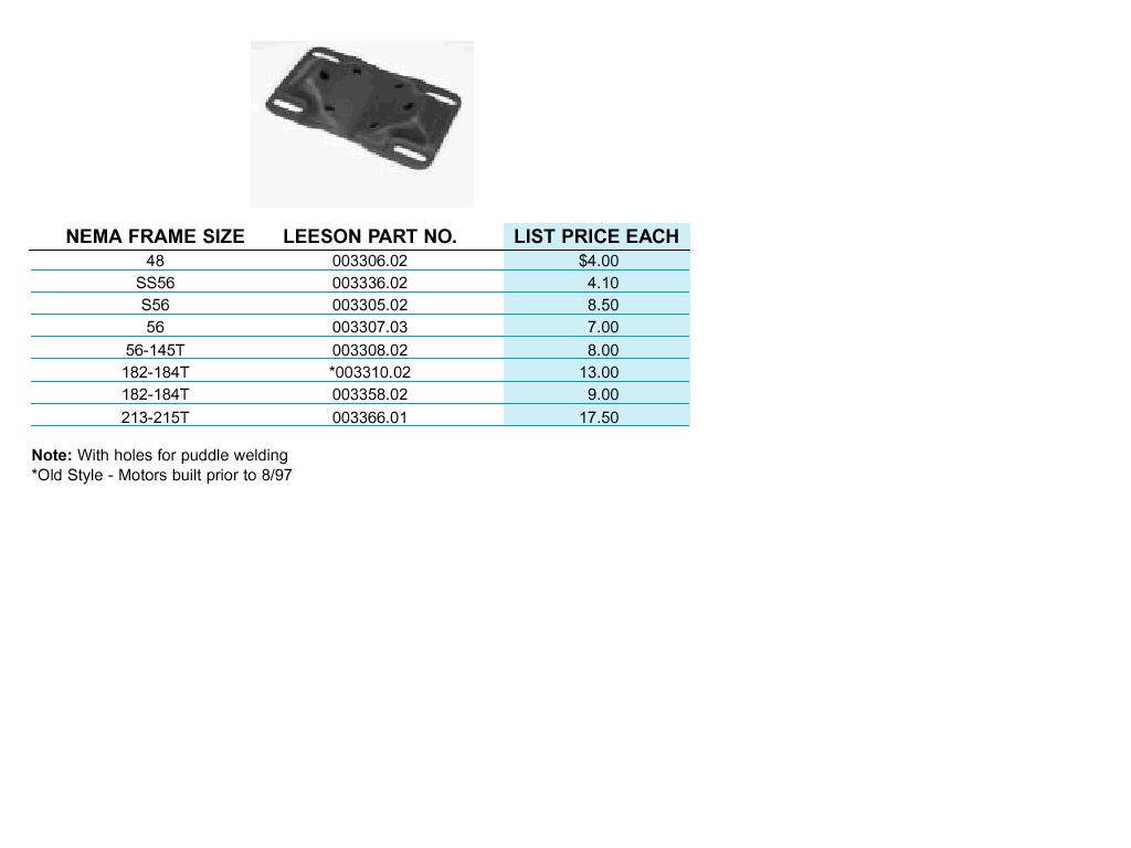

Here are some
other bases that may be of use
 Leeson Base Many other mfg offer similar ones |
