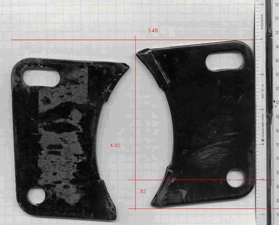

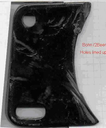

Next Web Person Keith as in Bohn was trustworthy or foolish enough to loan me these - Delta distributor created brackets for welding to a motor housing. Probably not a job for the timid, but in the overall scheme of things, doable. Pictures, comparison pictures and drawing follow.
Edges Aligned KB Bracket-2 Beer Bracket
Holes aligned

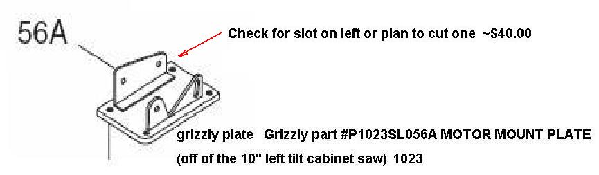

Here are some other bases that may be of use
Leeson Bases- Many other mfg offer similar ones
Griz Brackey
Griz Brackey
