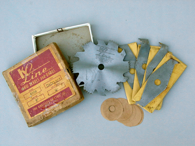

KECO’s core product was it’s Kni-Tron motion picture projector power rectifier and other equipment for motion picture projection. KECO also sold a number of tools under their K-Line brand. Twist drill bits and saw blade made by Vermont American were private labeled as K-Line.
Dado
K-Line 6" dado set #6058

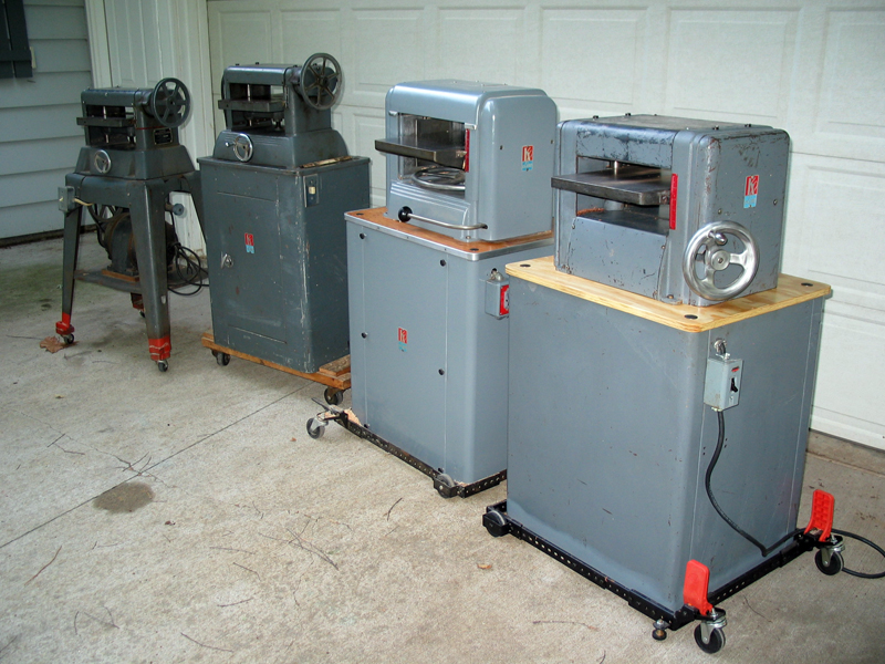

The K-Line Thickness Planers
Line up
Left to right - Yager, K2000, K2100 and K2200
pk
Illustration from the 1949 Powr-Kraft catalog.
KECO produced two models of thickness planers. The 10” x 2-3/4" Yager/K2000 and 12-3/4” x 4" K2100. The initial prototype K-line (Yager) planer was 12” in width but the final production model Yager planer was 10” wide.

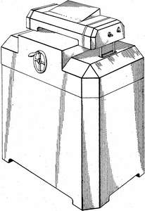

Edward Yagers 1945 patent illustration
Tom said Edward Yager designed the K2000 10” planer but has no clear recollection of Yager himself. Yager did apply for a patent for a “ornamental housing for a wood planing machine” in 1945. The patent drawing shows a slight resemblance to the later closed cabinet base for K-Line planers.

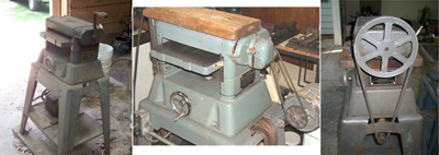

The cutterhead pulley is on the right side of the K2000. The earliest ad I’ve found is from the December 1938 issue of Popular Homecraft for H&H Machinery and Supply, (also on St. Clair, Toledo) and shows the cutterhead motor mounted top of the chip guard. The two previous ads, shown above, have the motor behind the planer. Later models were powered from below.
pulley
feed

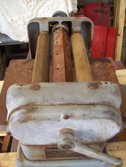

I am aware of three types of feed options for the Yager/K2000. The original was a crank type hand feed. This option was available for the entire production life of the planer. Two types of power feed were offered. The first was a geared type attachment using a second motor on the old style Yager. I haven’t found any documentation for this option, only a photo of serial number 1147. The second powerfeed option was driven from a common motor utilizing a countershaft below the open stand or closed cabinet option.
